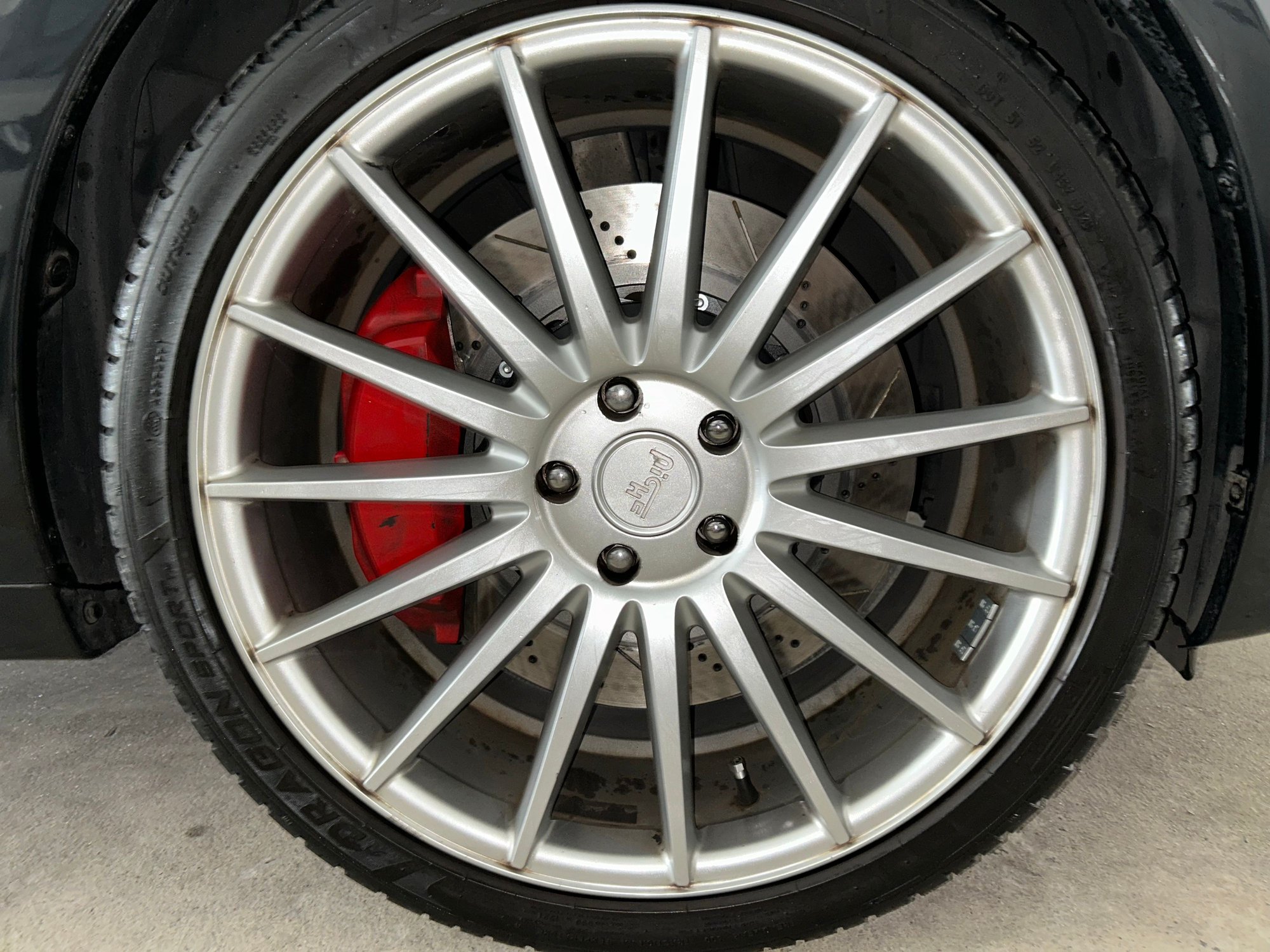

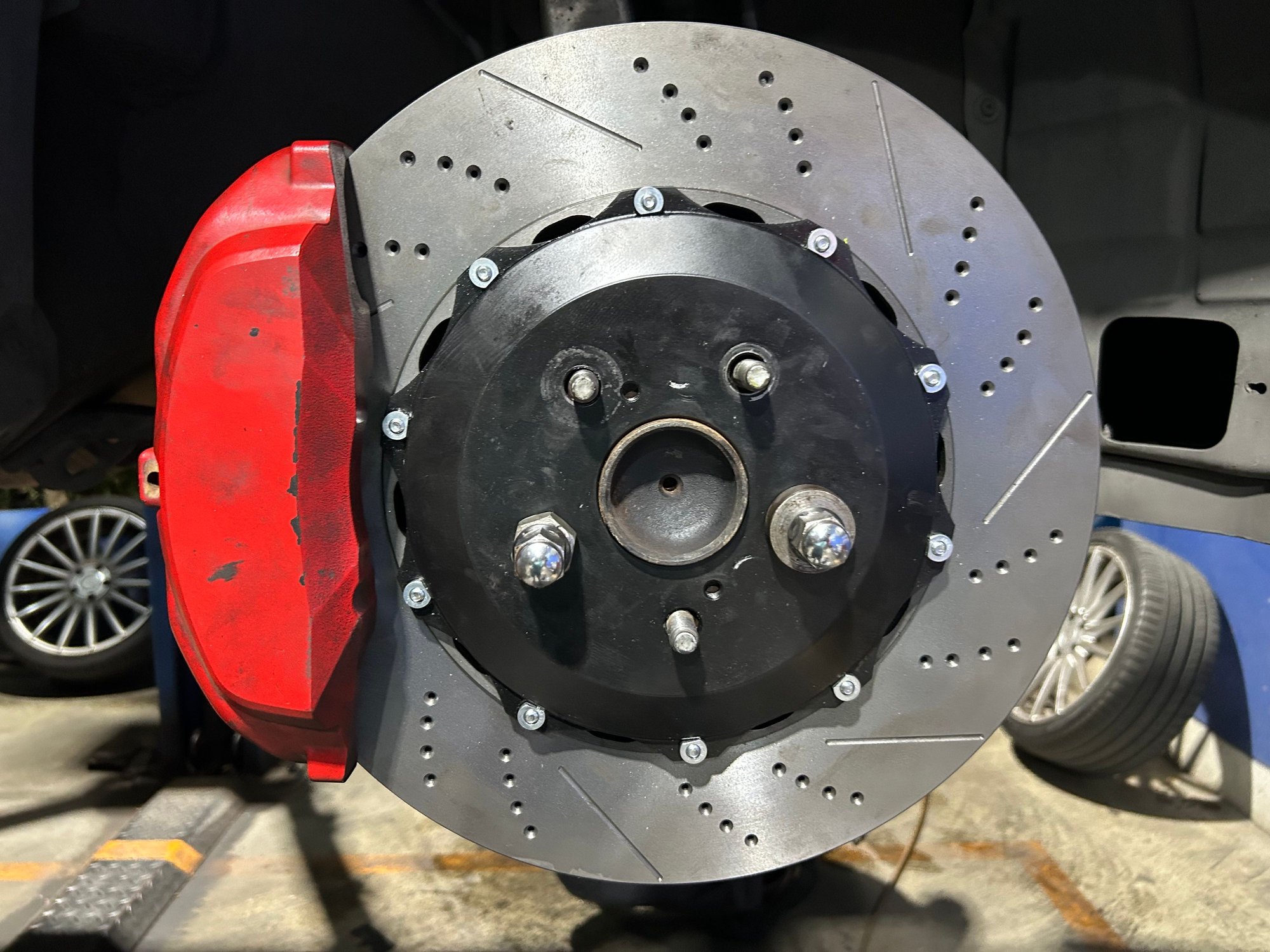

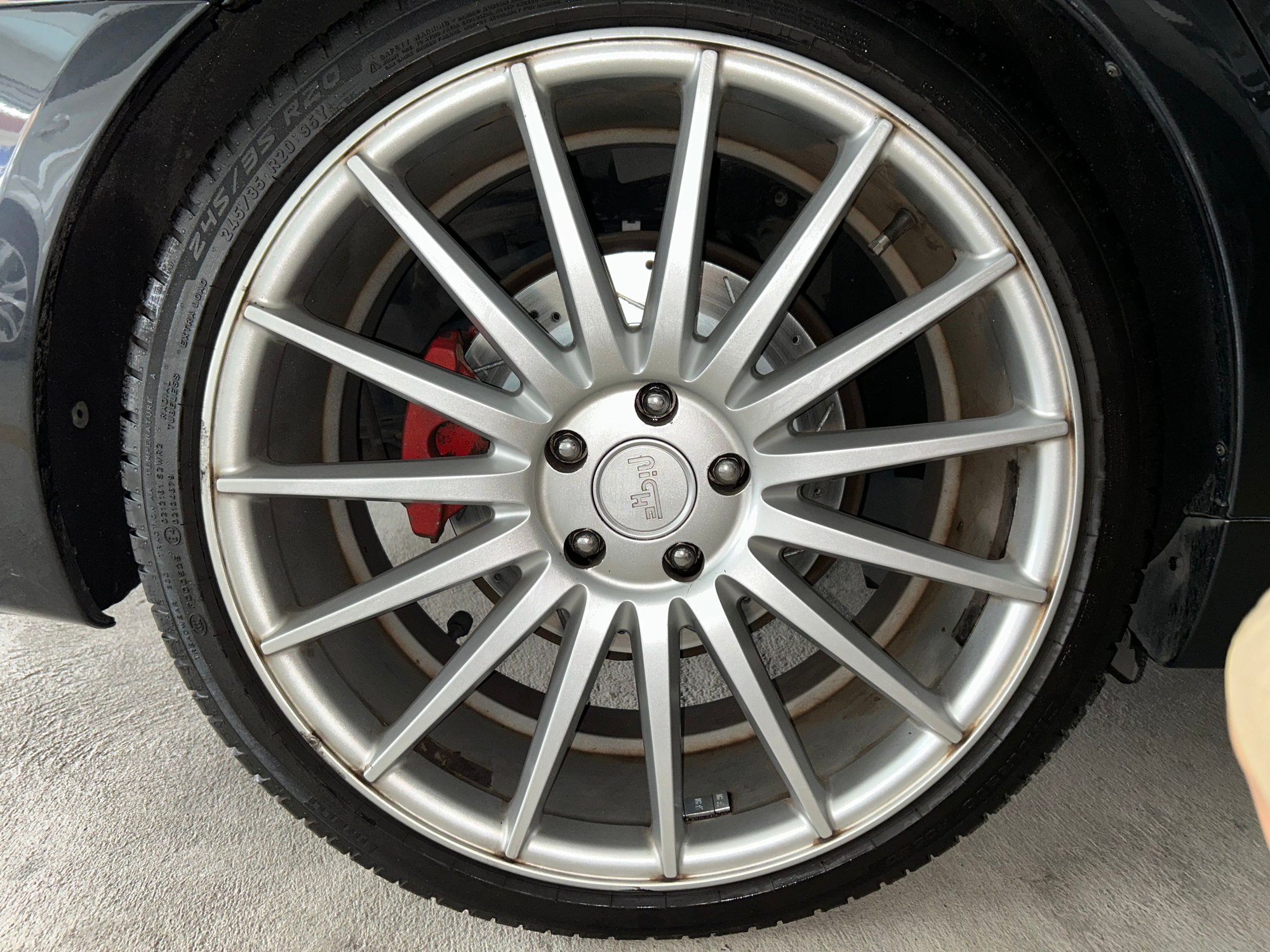

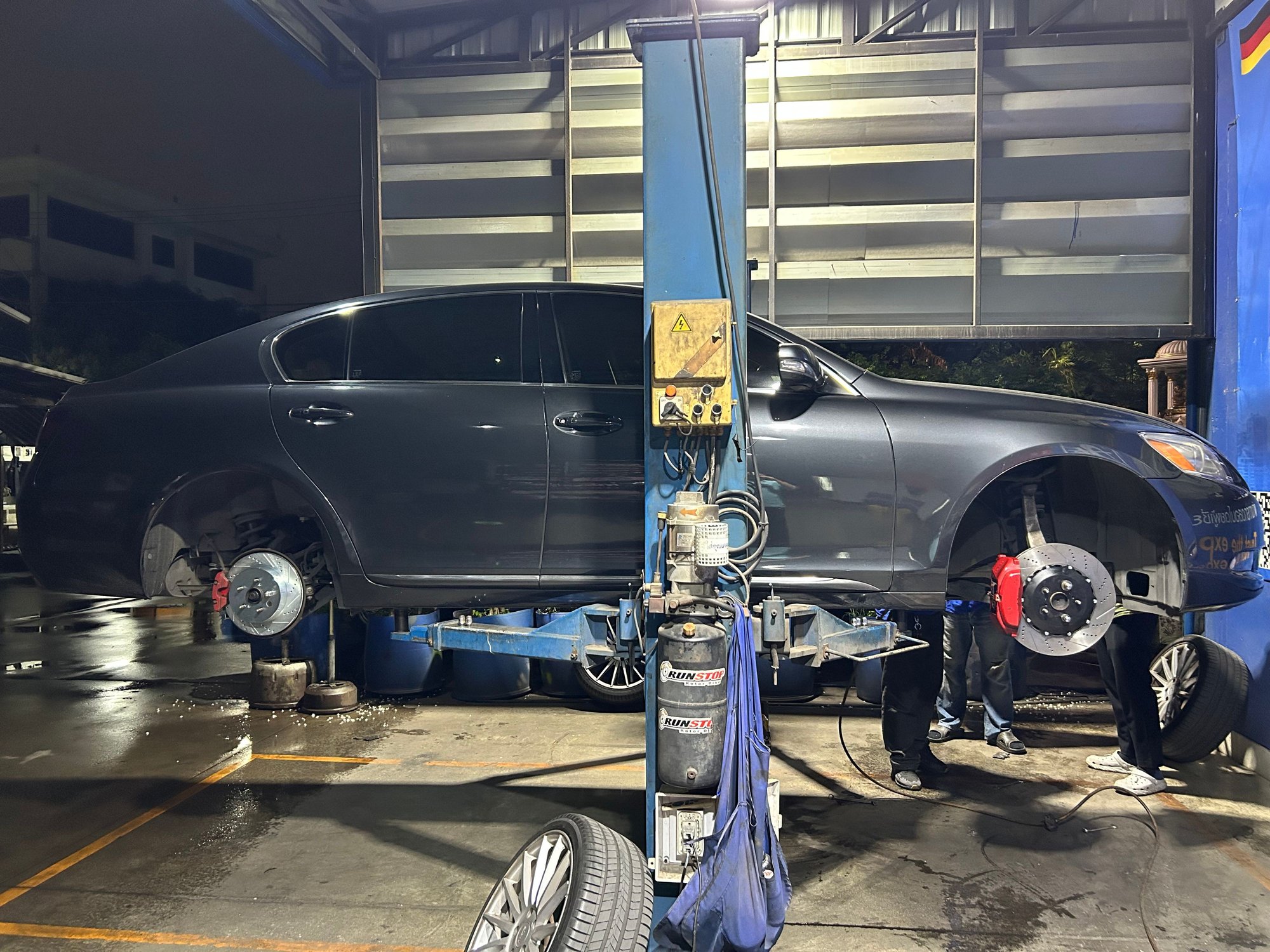

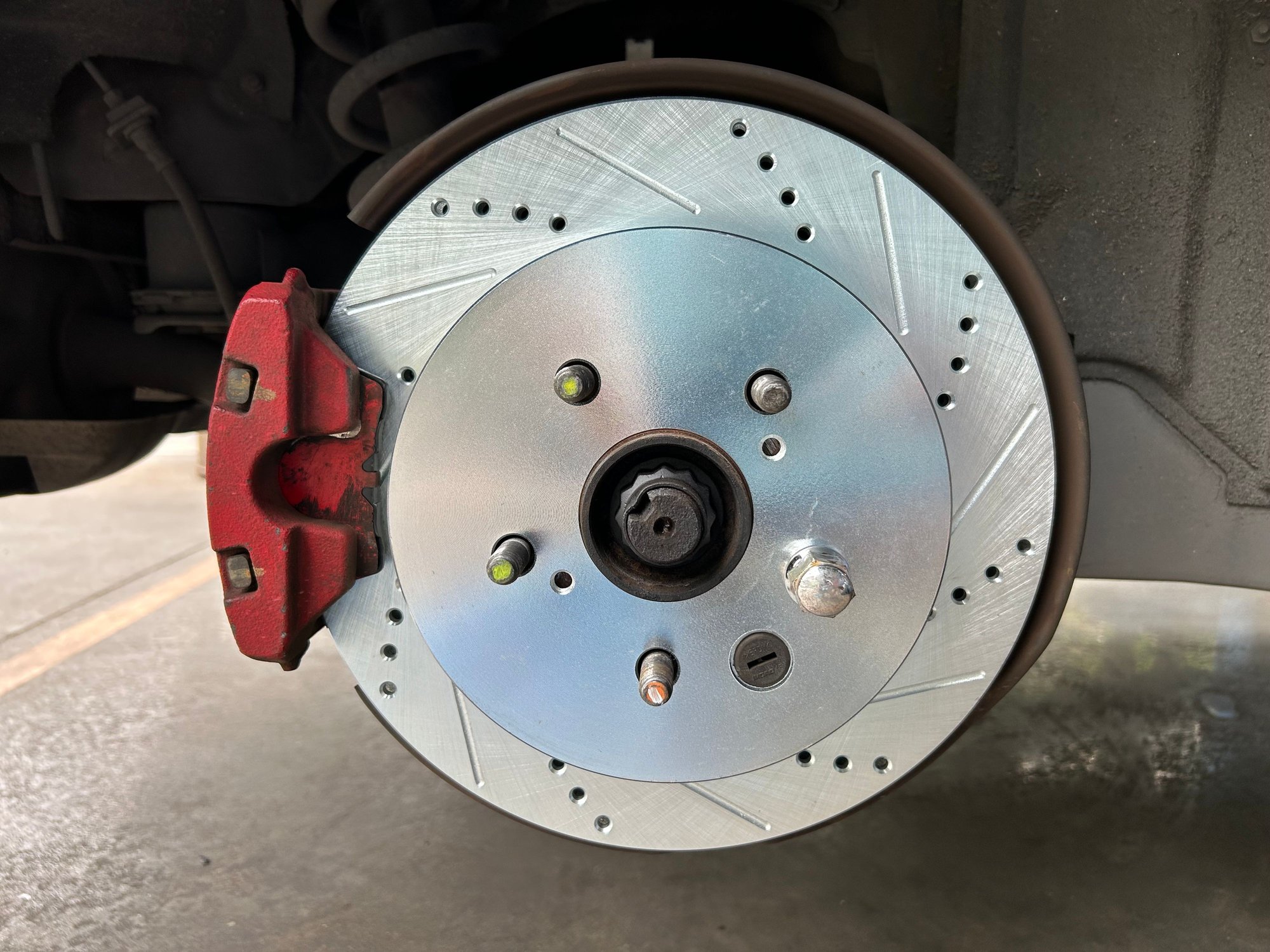

Hey there, resurrecting this thread because I think it's the right place?
So anyway, the front rotors for my 2009 GS300 were due for replacement and Lexus TH was going to charge me about $800 for the stock front rotors and pads. So I thought I'd look around if there were any aftermarket options available locally. After a bit of sticker shock at the Brembo options, I couldn't even find any stock fitting options here. So I came across these guys here in Thailand, Runstop, they manufacturer rotors and calipers for aftermarket upgrades.
Brought my car to the factory where their mechanics had a look and said they could make a custom hub for me to fit one of their 380mm rotors and I could use the stock calipers with some minor modifications. Only problem was, they didn't have anything available for the rears. Luckily, had a friend coming over from the US, so I ordered a cross-drilled and slotted stock size for a drop-in replacement. Didn't know the damn things were so heavy! Bless him for lugging it halfway around the world to me here.
Made the appointment and about 7 hours later, BBK installed in the fronts of my car. Photos as below. Probably should have done it at the same time, but will go back to repaint the calipers and put in the braided stainless steel brake lines. New front discs and new pads all around, they installed the rear discs for free, since it was just a replacement, for $730 + $90 for the rear rotors I got stateside.
Will probably look into a custom rear option later, but given the car has a front weight bias already, probably no need? Do need to replace my shocks, which is probably overdue, considering my car just hit the 200K KM mark a few days before the brake upgrade...
