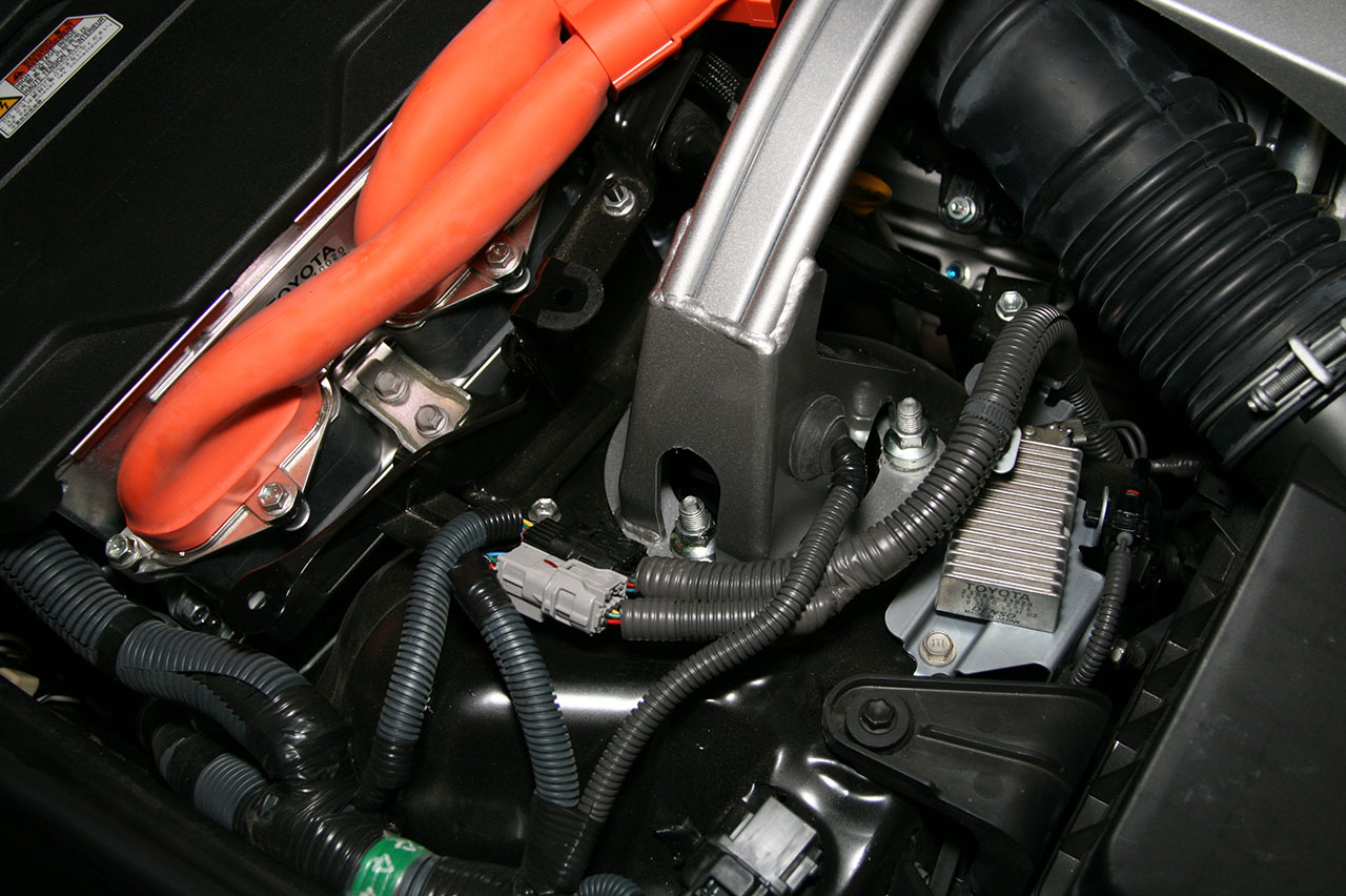

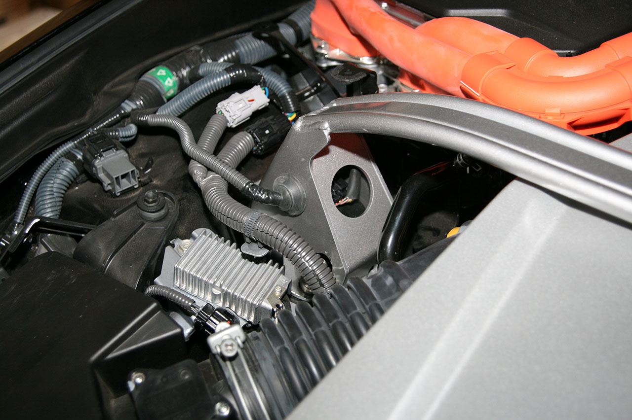

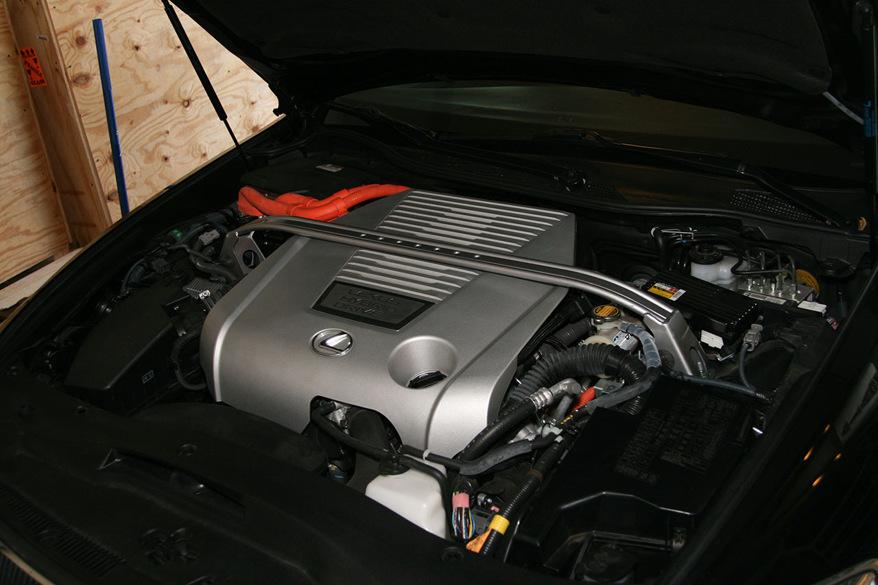

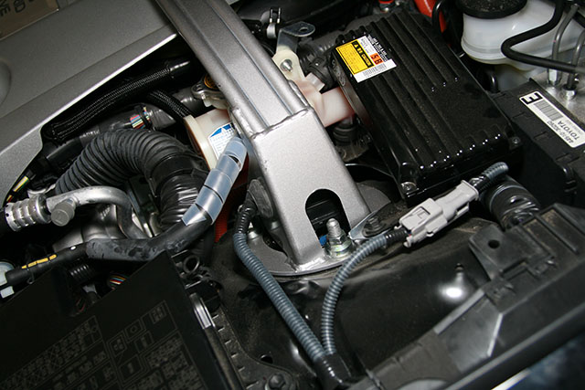

I’m not sure if anyone here has previously installed a strut tower bar on their 3GS, I definitely couldn’t find a post about it, so here it is mine… I believe only Tom’s has a strut tower bar for the 3GS: http://www.tomsracing.co.jp/comp/lex...680-tgs80.html
I ordered my strut tower bar from Luis at Carlson Toyota, he made sure the right part was ordered (the bar for the 450h with APSSS), no, the real pain in this process is the time it took to get the part in, I placed my order mid December and received it Friday 21 march, around 13 weeks after placing my order! Waiting was indeed a bit on the long side !
Installing the bar was really a simple job (keep in mind this is for the 450h with APSSS)
- remove the left and right engine cover
- remove the protections on top of the strut tower (APSSS only)
- unplug the APSSS electric actuators
- remove the screws on top of the towers
- reroute the actuator cable trough the strut tower bar
- jack up the front wheels on jack stands (I read somewhere that the front wheels needs to be off the ground to properly install theses strut tower bar)
- plug in the APSSS electric actuators
- install the bar itself
- torque the screws that hold the bar
- done (do not forget to unjack before a test drive...)
Here are some pictures of the finished installation. After a short test drive the car does feel more composed and the steering feel more precise and consistent, I will report more tomorrow after I have the opportunity to drive the car more.

Nice to know it fits over the AVS (Adaptive Variable Suspension) control modules. Now the question is, will it fit over Tein's EDFC controllers.
looking at 3rd picture, i say unlikely
