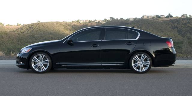

Hi,
I must have made a typo, I used the NF210 they works just fine, lowering a little more than the specs Tanabe have on their website due to the larger weight of the car, but nothing drastic. Here is a pic of the car lowered with the OEM wheels:
Click for hi res view
I'm currently running 19" (19x8.5 front and 19x9.5 back) without any rubbing, your mileage may vary with 20" and different offset.
