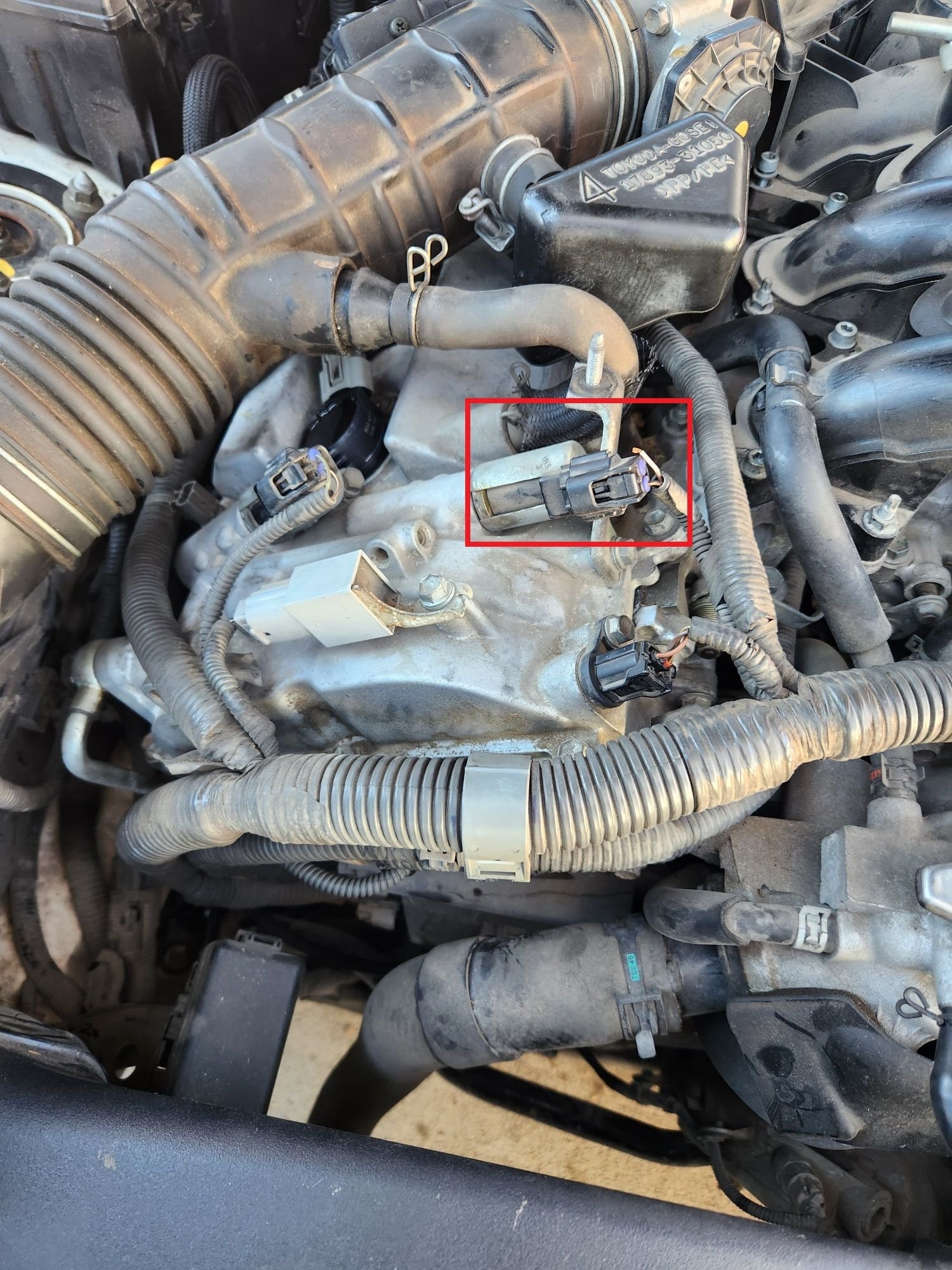

We fixed up my wife's 2006 GS300 AWD (3GR-FSR) with new plugs, coils, and valve and intake gaskets.
Upon reassembly we noticed the wire out of this connector. Can someone help me identifying which it is? I know it's to a solenoid. We just need to replace the terminal.
There was a VSC check engine light on when we tested it, but it ran just fine.
I pulled the code and got this:
P0010 - 'A' Camshaft Position Actuator Control Circuit/Open Bank 1.
From this diagram, I think it's E51 - Camshaft Timing Oil Control Valve
https://charm.li/Lexus/2006/GS%20300...sor/Locations/
Can someone confirm? Do you know where I can find a part number for just the terminal, or the whole kit, if I can't get that alone?

As far as I know, that information is only on the TIS website. Hopefully someone will chime in and have a solution i'm not aware of.
Alternatively, look on the back of that connector, there should be a 5 digit number. For example that VVTi connector on the gs460 has 11162 stamped on it. When you add 90980 to the front of that number you get the part number for the connector (example: 90980-11162). You can then call the dealer with the connector part number and ask for the terminal part number.
