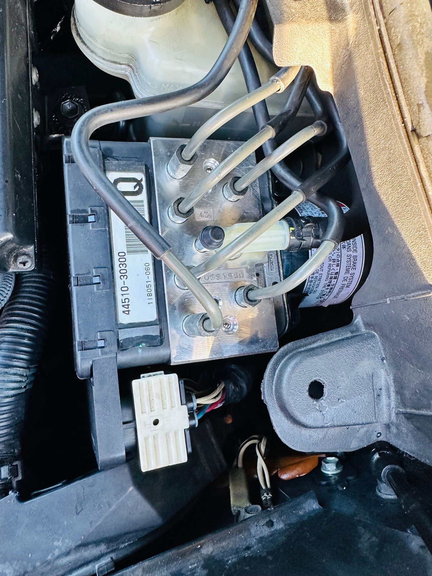

Also GS460 in Florida. Lexus North Miami wanted $3500. I ended up getting a new OEM one from Toyota, $1700 and paid a JM Lexus to install and program it, since it required techstream. Altogether around $2,500 in 2021. Part number:

And yes, the parts and sometimes the part numbers for Toyota and Lexus parts can be the same. The original actuator assembly in my 06 430 said "Toyota" on the label (as you can see in @Oceans13 's picture above).

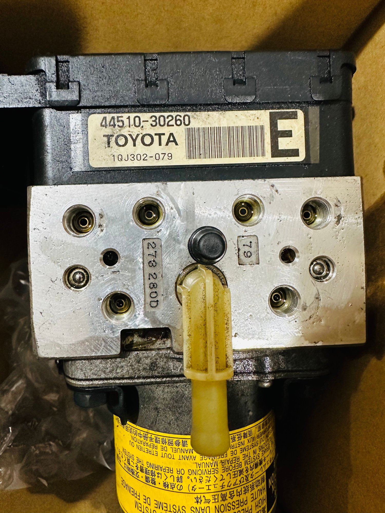

Ended up ordering the ABS from Lexus of Kendall. Saved around $445 on the part itself by ordering through a friend who has an auto shop. List price for a new unit is $2,222.40, I paid $1,777.92. Almost went with a used unit on Ebay, but in the end I couldn't bring myself to pay $700 plus for unit that could potentially go out at any time. I'm not sure if Lexus ever fixed their design flaw and these new units will not have the same fate as the original ones, but at the very least I can expect a few good years out of the new ABS. Went to a local independent shop and had them replace the ABS, bleed the brake lines and re-program everything. I've been driving for 3 days so far and no codes and brakes feel great again. GS460 lives to fight another day.
