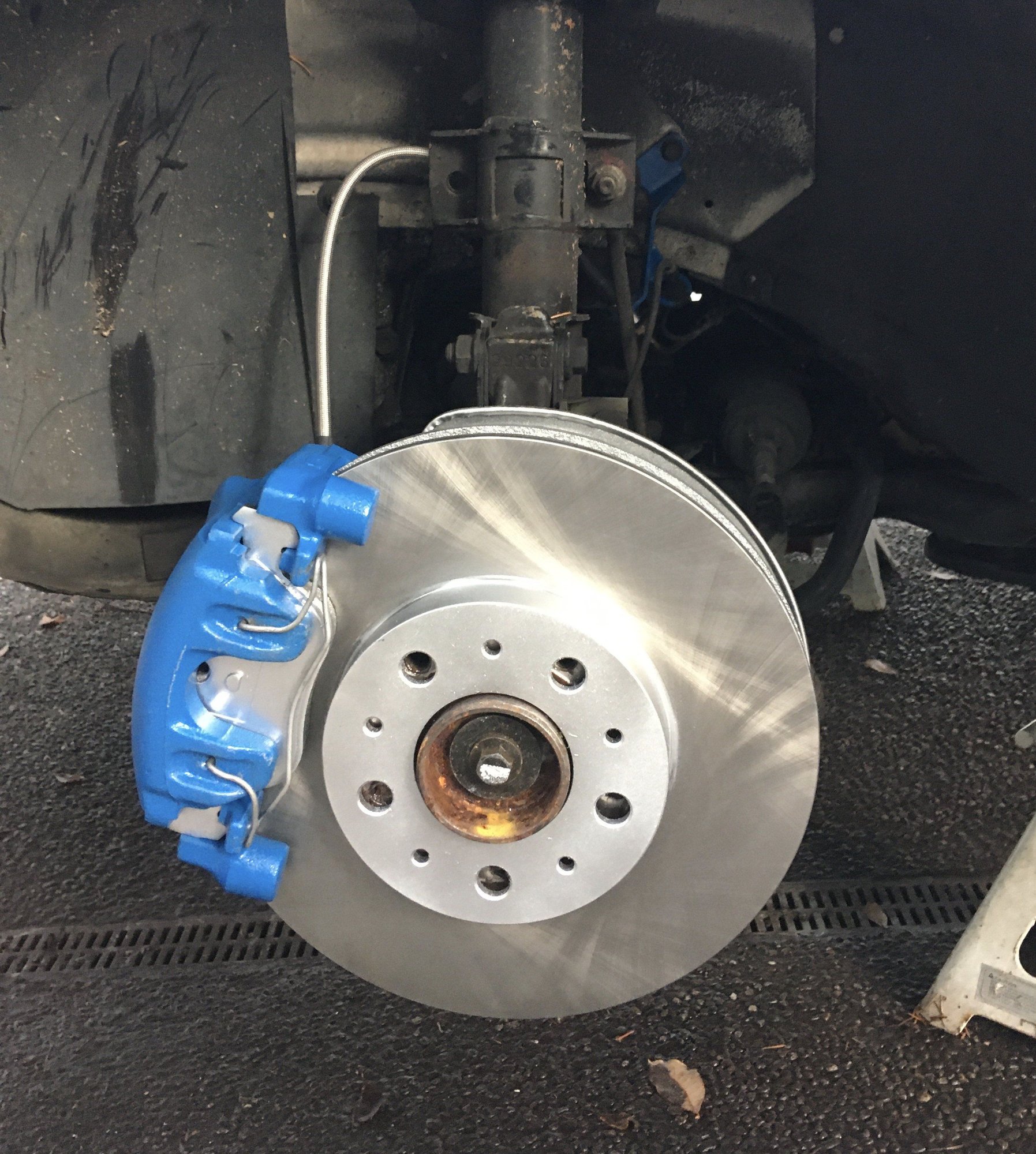

I do recommend if you take a little bit and mask off the piston area and bleed screw, then prime and paint it you’ll be glad you did later. Even if zinc coated, clean them and hit with rustoleum etching primer, then any Rustoleum top enamel (their wheel paint works well on calipers, is cheap, I’ll link it).
I had to take a wheel into Les Schwab today for a warranty on a tire. The manager was impressed with the wheel finish and asked me who did it. I said that I had, and with mainly these two paints (and extensive prep). Cleared on top for the wheel but not necessary on rotors or calipers.
Metallic silver paint (other colors too):
Amazon Amazon
Etching primer is clutch for getting good adhesion and durable results:
Amazon Amazon
Plus painted brake bits look good. This is my Volvo, not the GS.
