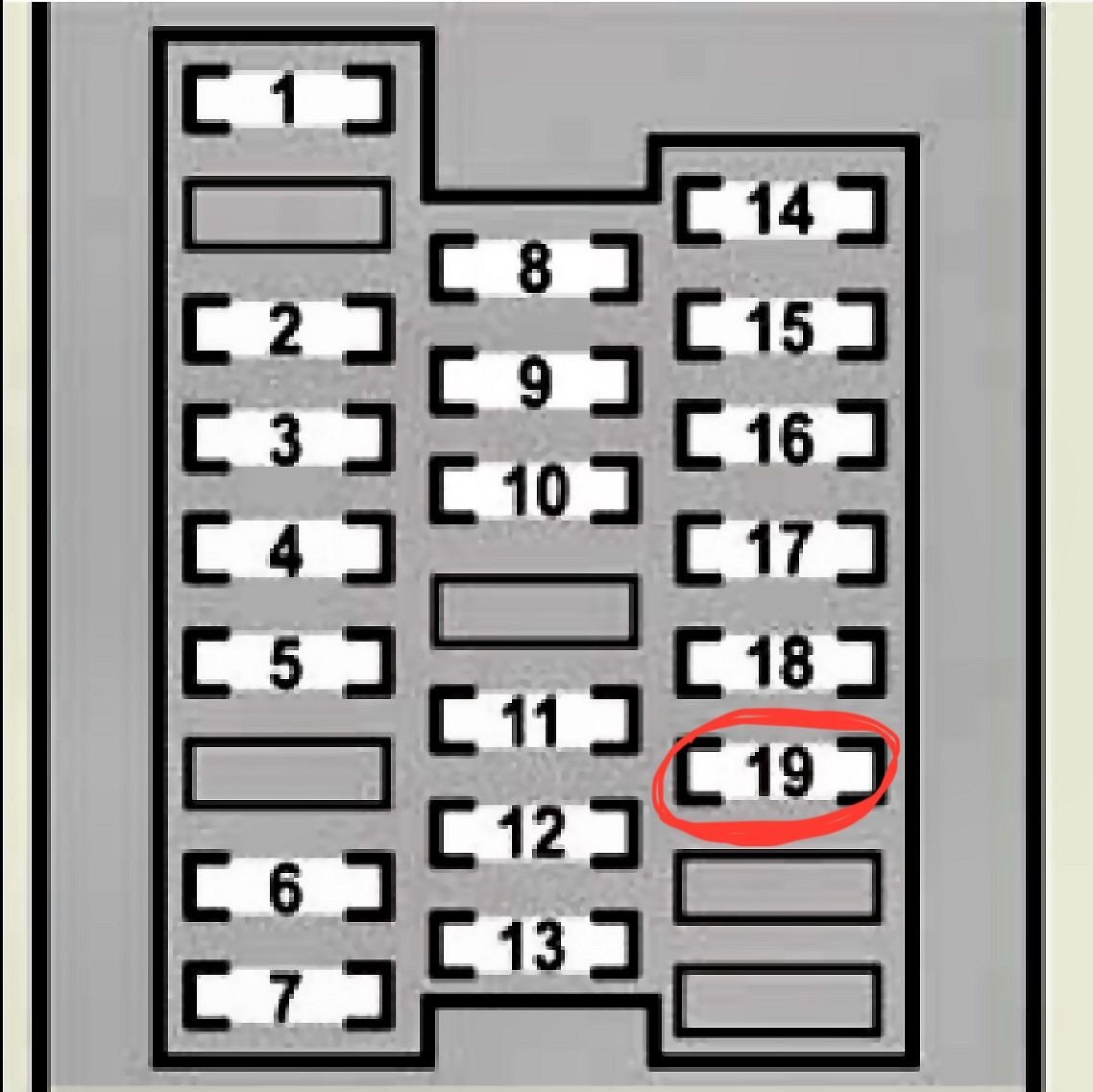

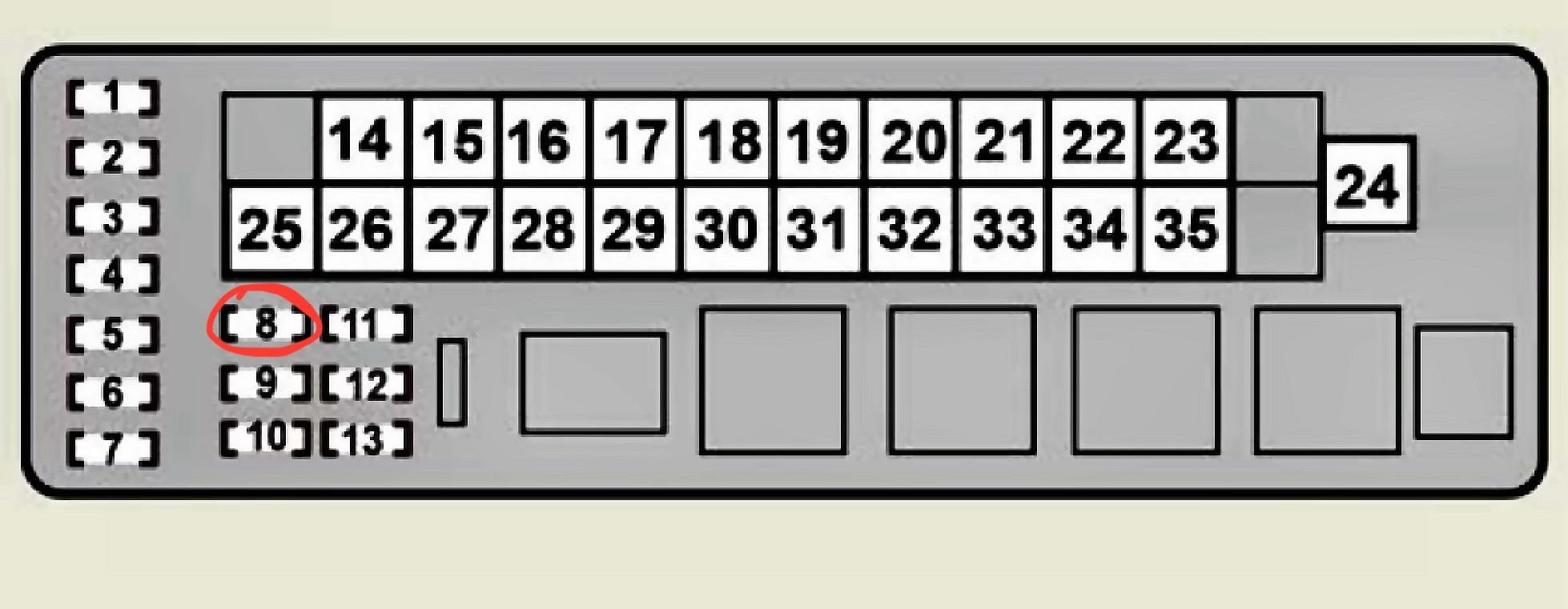

I have a 2008 GS460 that I do not use often. It is now having electrical issues and I am not sure where to start with that.
Below are the issues, not sure if they are related or two separate.
I was driving the car 2-3 weeks ago and when I was almost to my home it started to overheat. I let it cool off rest of the day and then when I checked it, the issue was that the radiator fans were not turning on. I did not have tie to troubleshoot at that time, but everything else seemed fine.
Yesterday I tried to look into it more, but when I got into the car I was not able to start it. No response at all when pressing start button, nothing comes up on the dash. I first figured the battery died so I charged it overnight and tried again this morning. Still nothing at all. I also changed the keyfob battery just in case and I tried to put in a known good 12V battery from another car.
At this point I noticed several other things are not working. Such as:
- Dome lights
- Power seats
- Start Button
- Brake Lights
- Alert dinging sound when doors are open
There are some things that still do work
- Headlights (both low and high beam)
- Emergency flashers (front, rear and side mirrors all work)
- Interior lights on doors
I figured the interior electrical issues are all connected to a single module/fuse, but not sure which one.
I feel like radiator fan is a separate issue, but I wanted to mention it in case it was related.
Would anyone have any advice on where to start?

In case anyone see this post and has same issues on a GS460/350
The main fusible link was burned out. Part to replace was about $100 and took me about 2 hours to replace. Pro could probably do it in an hour or less.
