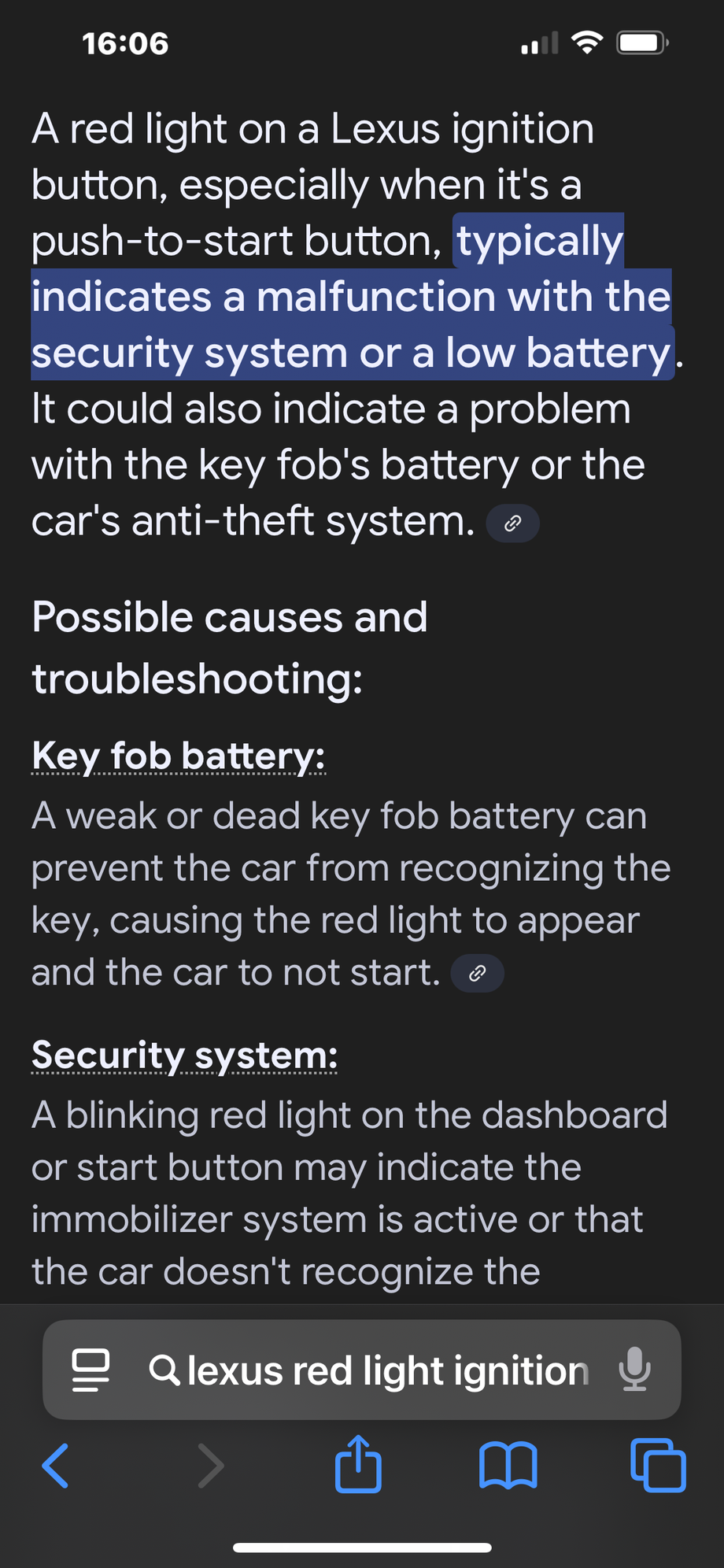

does the light on it turn green when the fob is in the car?
Old Jul 17, 2025 | 03:19 PM
Blad3brown's Avatar
Blad3brown
Joined: Jun 2025
Posts: 16
the light is red.

Old Jul 17, 2025 | 04:19 PM
Blad3brown's Avatar
Blad3brown
Joined: Jun 2025
Posts: 16
thank you I’m going to replace the battery in the fob. Is there a way for me to reset my alarm? I read something somewhere else that said start, turn off and then open the door and close it 3 times. Not sure how legit that advice is
