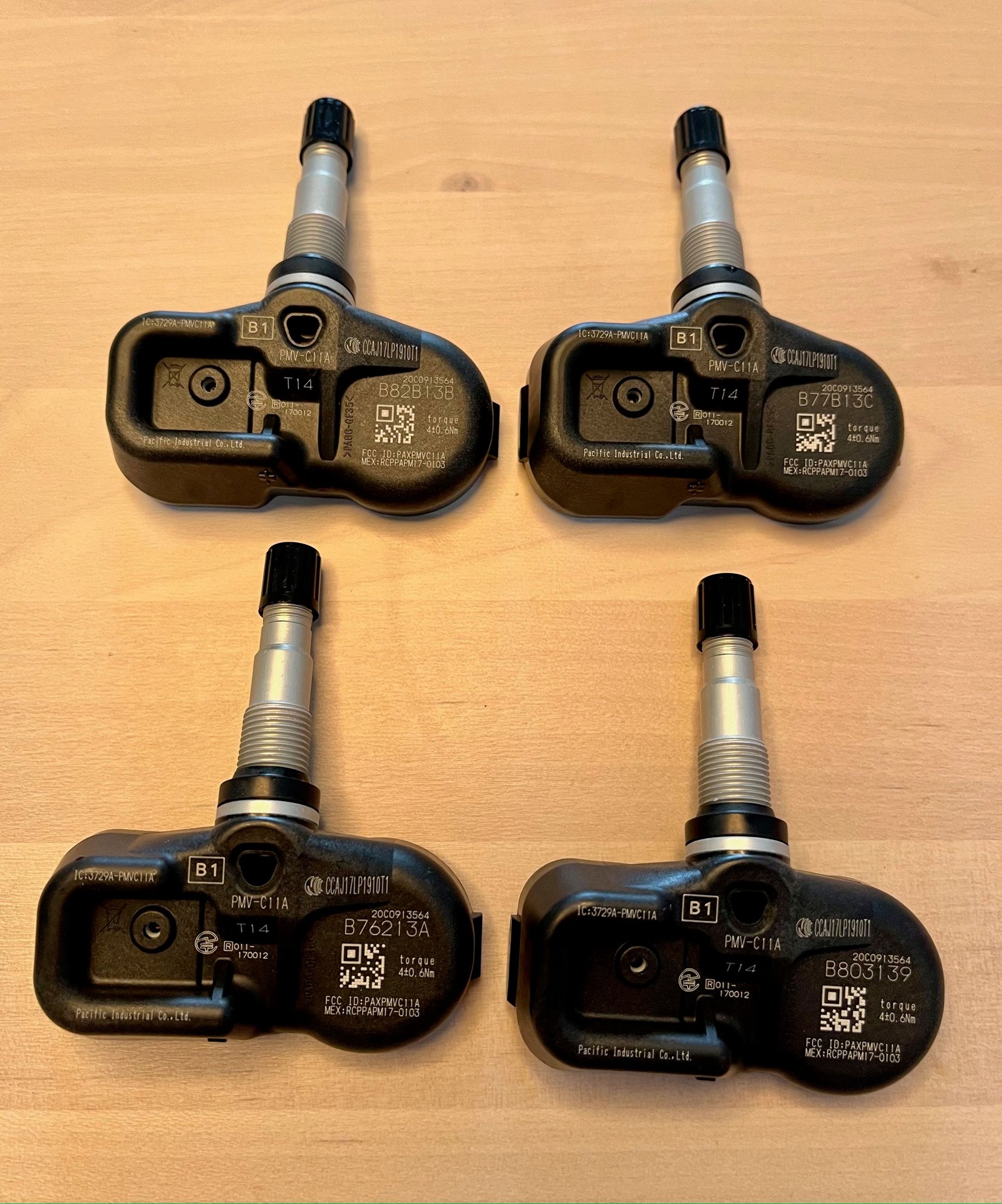

Specifically, the Denso sensor model 550-0103 is literally the exact same part as you'd get if you purchased from the Lexus / Toyota dealership part number 4260733022. Toyota gets the part as an OEM part from Denso, who gets the part from Pacific Industrial Company. The original sensors that game in the 3GS are Pacific part number PMV-107J, which corresponds to Denso 550-0102, and Toyota / Lexus 42607-33021. Pacific updated the sensor, and the new part is PMV-C11A, Denso 550-0103, Toyota/Lexus 4260733022.
The ID numbers on the sensors need to be programmed into the 3GS' tire pressure monitor computer. Most shops should be able to do this now. Take. a picture of the sensors prior to installation, so you can read the ID, and then have your shop or dealership program them. My local Costco installed the new sensors for free when I got new tires, and I programmed via TechStream, but if that isn't an option, replacing all 4 sensors should cost:
$34.79 x 4 = $139.16
Dismount / remount tires: $20 x 4 = $80
Program sensor IDs: $120
Total: $339.16 for 4 new OEM sensors, programmed, that should last another 10-20 years.
