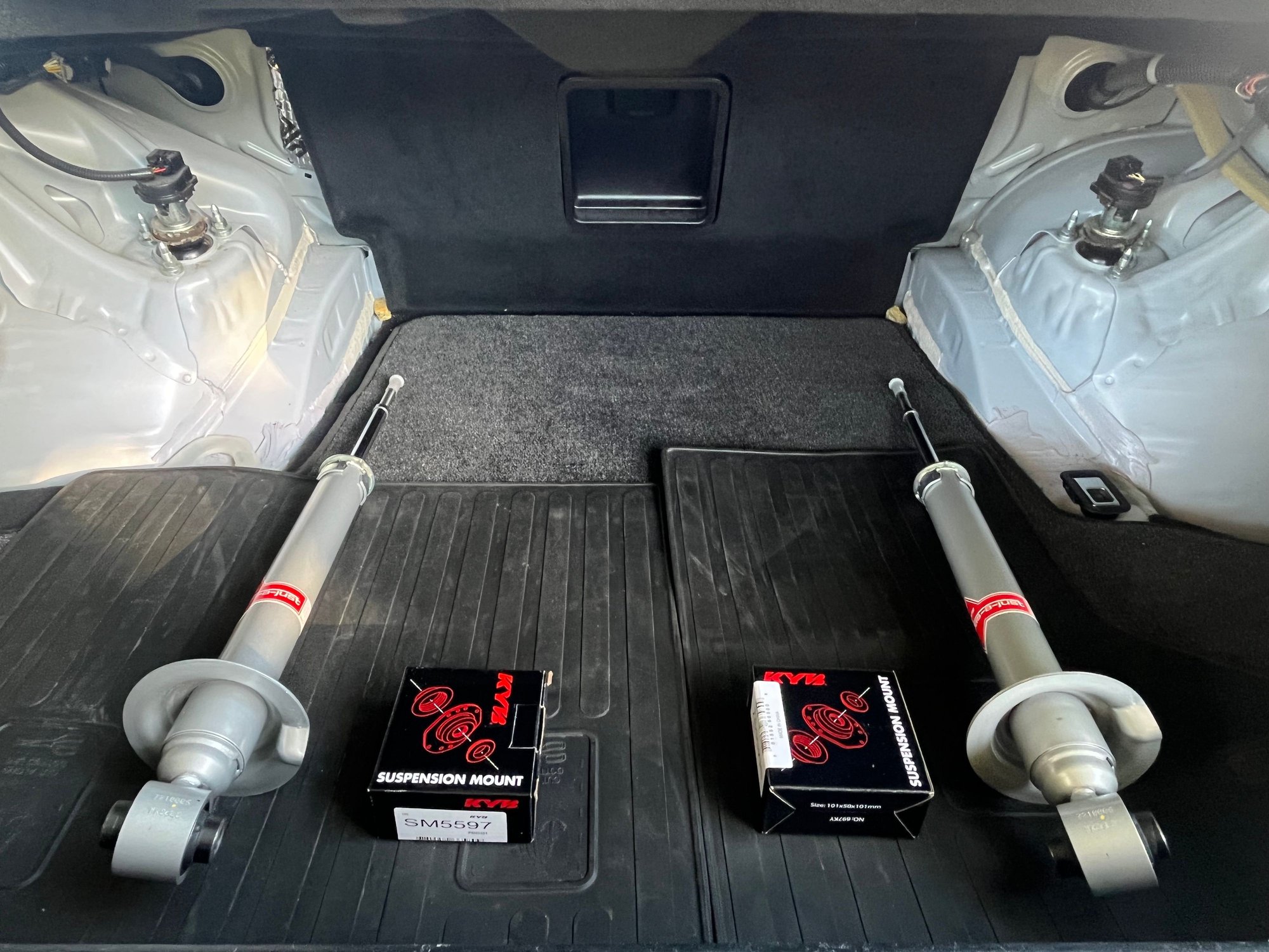

I have a 2008 GS460 and installed the KYB last year. They are on RockAuto for the GS350, rear, with AVS.
They is the same as the OEM ones. Make Sure to get the new mounts as well.
You can do front or back alone, but may as well do them both, since your car is goning on a lift anyway. These are the fronts:
Also, post some pics of your 460.
