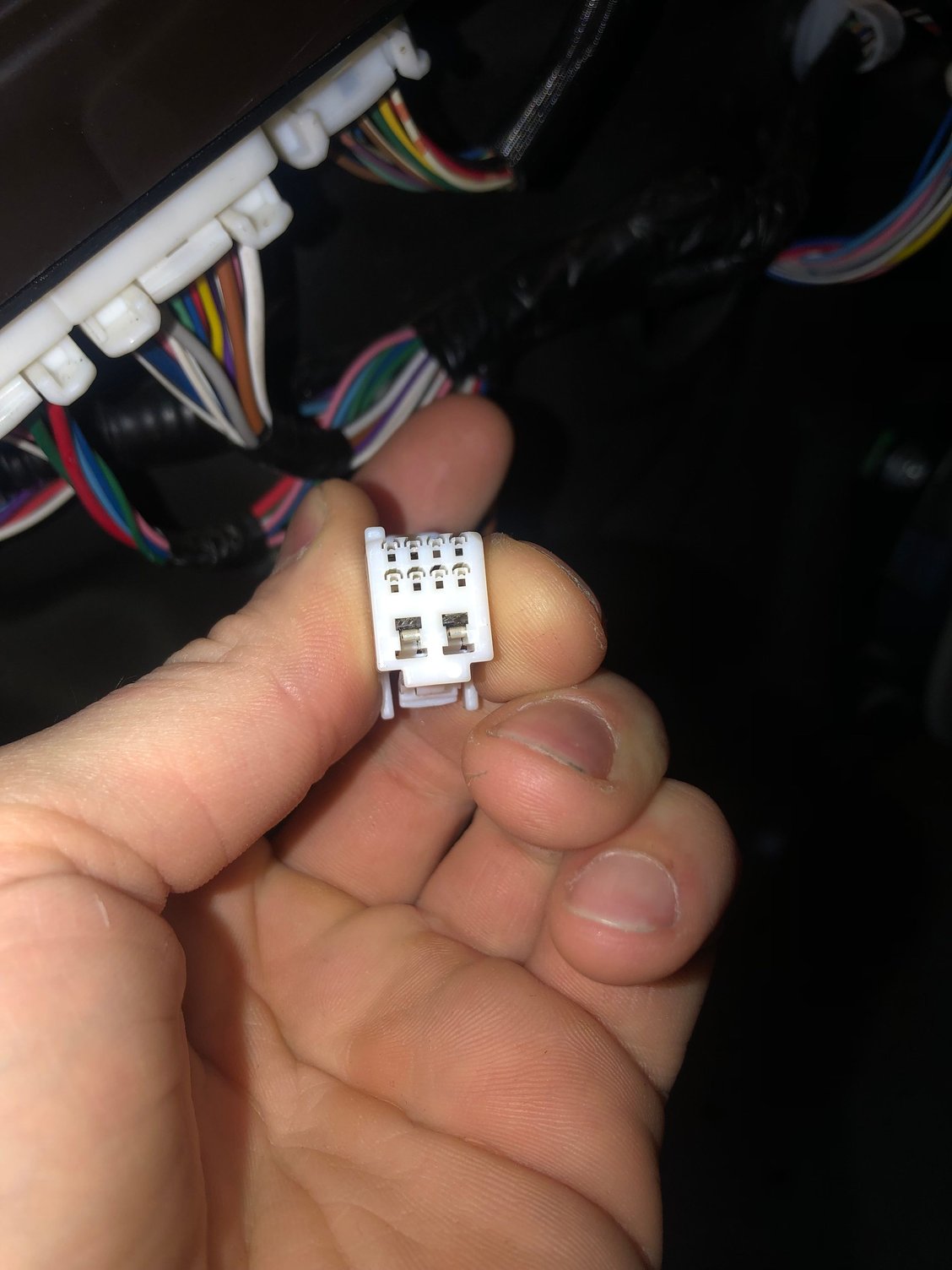

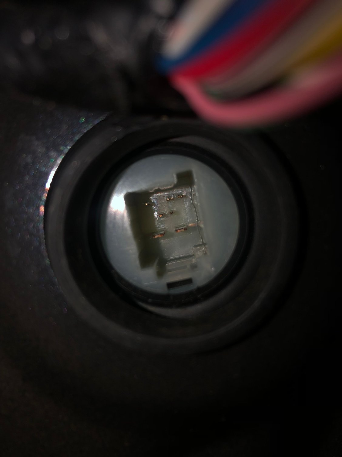

Hey everyone, I’ve been having some issues after needing to replace my driver side door. I have an 07 GS350 AWD and the donor car was also an 07. The window was rolled up on the new door, I installed it and started swapping over the panel/side mirror from my old door. As soon as I plugged the door panel in the window rolled itself down, I could hear the motor working while I did so. I didn’t think much of it until after I finished putting everything back together and realized it wouldn’t roll back up. The power window controls are working, I can roll all my other windows up/down but the driver window control is just blinking green and won’t communicate with the window, I’ve tried programming it multiple times. I figured the next culprit would be the regulator/motor so I started to swap the one from my old door over since I knew it was working fine. Only issue is the plug is completely different so I can’t plug it into the new door. Looking around online and I can’t find any replacement motor/regulator with this plug, does anyone know where to find one/what other issues I could look into first? I’ve included pics of the new doors window motor plugs that I haven’t found online anywhere. Thanks!
