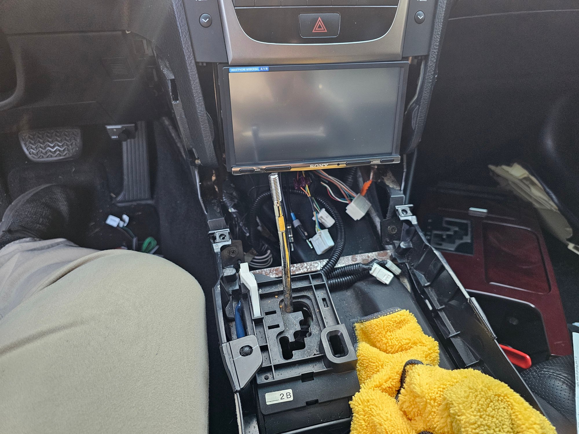

I'm changing out the factory stereo for a Sony XAV-3200. I'm one of those guys that do what they say can't be done. I did my research and figured which of the wires I have to have connected to the factory stereo in order to keep function of the HVAC controls. Its not difficult but time consuming. I just got tired of the bland factory sound. Even after installing an Audio Control DM-608 with Audio Control amplifiers, I still wasn't satisfied with the sound. It's just something about amplifying sound coming from another amplifier (the factory amp) just don't sit well with me. So I'm relocating the factory radio/CD changer to the trunk. I'll post my progress and finish when I'm done.
The test fit

Not finished product but installed and connected.
