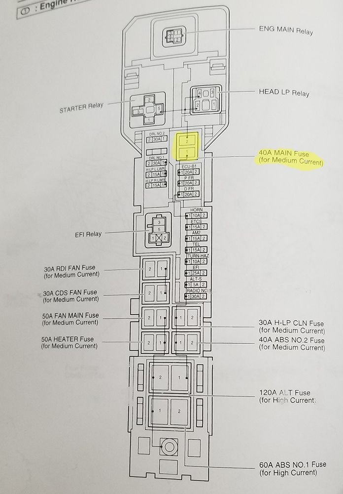

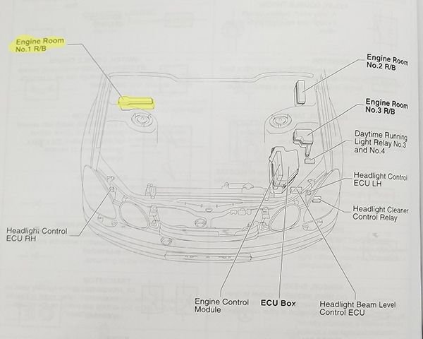

Here's the main fuse location.

Thank you for the diagram. I'm going to go out there tomorrow and see what I can do. Also since it's a push to start I would have to have a program to key to wake the car up right or can I just get in with no key and hit the button and it will wake up but it will not detect the key since there's no key present? I called a locksmith here in Virginia and it's going to be $300 and something dollars to make a key in program it because it's pushed to start they say is there anyway I can bypass that awake the car without a key?
