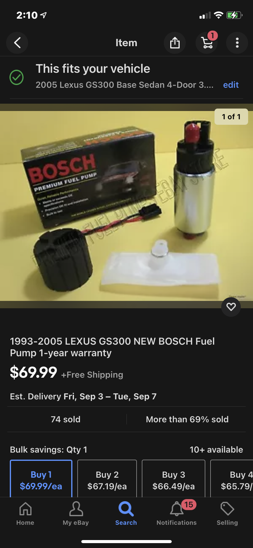

“would you mind to give link and model#? I have 05 GS300.“
This is a snapshot I pulled in case the link dies and someone wants to find one in The future.
And then here is a hyperlink
https://www.ebay.com/itm/Bosch-Fuel-...-127632-2357-0

I don’t know if my ‘99 GS400 uses the exact same pump as your ‘05 GS300, when I punched in the specifics for your car, this was the least expensive Bosch that came up. So…. It’s been 3 years since I did this job and haven’t had any issues with it. So even though it was inexpensive, it does the job asked of it.
https://www.ebay.com/itm/1993-2005-L...-127632-2357-0
