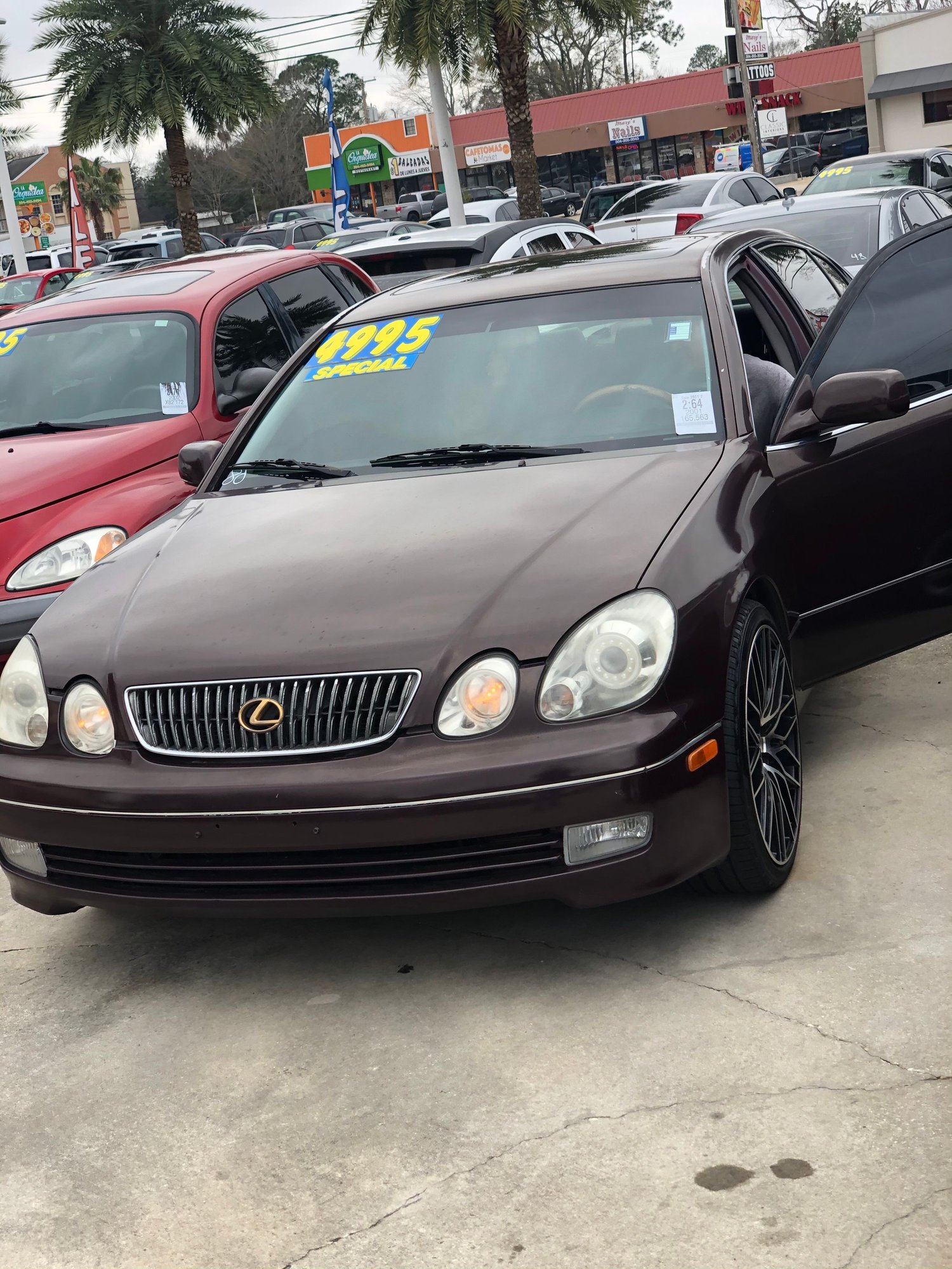

These cars rarely have any major issues that cannot be easily addressed. Mostly just wear and tear stuff. The picture seems to show that either the headlights are not quite right or the hood is maybe out of alignment. The headlights look aftermarket. I would also confirm no major accidents. The color looks interesting. Is it a dark brown? Don't think I have ever seen one quite like that. I like it.

Yes, the headlights are definitely aftermarket. No accidents. Also, in the photo the hood was closed over, not completely shut. I had just looked around under it with my flashlight to see if I spotted any oil residue etc and decided to take a pic for the thread with my follow up questions. The color is like a black cherry or maroon. I’ve seen the color on a few

I have seen many of these cars with sticky hood latching cable or latch mechanism. You might want to check that as well.

The hood is fine I just didn’t shut it all the way completely before taking the photo. Good looking out
