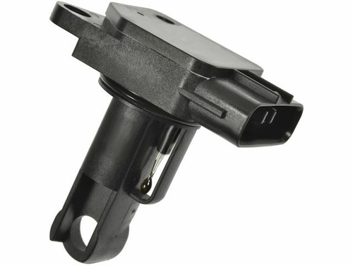

Quote:
thanks
MAF = mass air flowOriginally Posted by Ajchan
what is a MAF sensor?thanks
https://i.ebayimg.com/images/g/Hg8AA...mfH/s-l500.jpg
Could also be your fuel pump. Before mine went out I was in cruise control and the car seemed as if it was searching for a gear. Having to press the pedal further for the same speed also points to low fuel pressure. You can have a fuel pressure test done and that will tell you.
