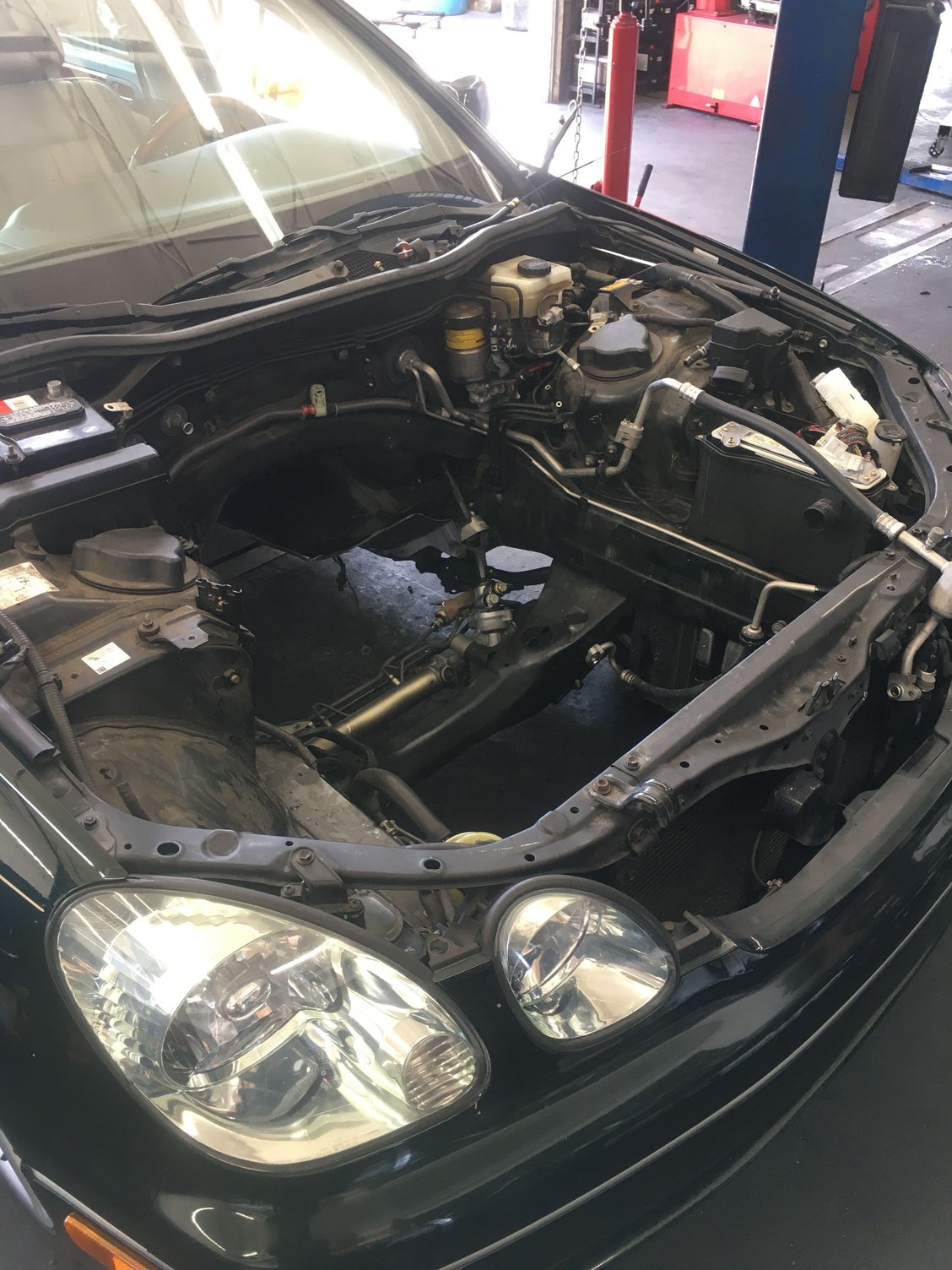

This is a GS430 I pulled the engine out of yesterday. Trust me, you wouldn’t want to go this route lol. There is nothing to support the transmission, so it has to be pulled also. Which means exhaust, and driveshaft too of course. Not an easy task.

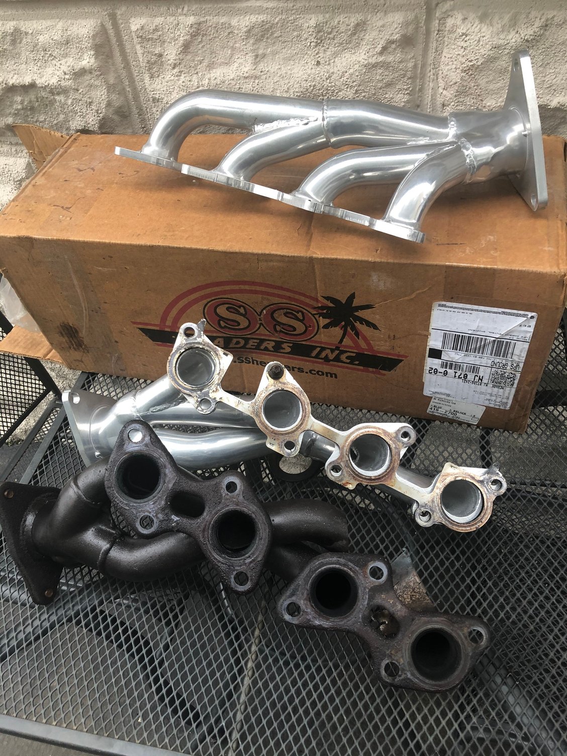

Sometimes I think I must be the slowest wrenched out there. 16 hours later I finally got one side (drivers, the hardest) out.
Sometimes I think I must be the slowest wrencher our there. 13 hours later I have one side (drivers, the hardest) out. I think a good six point socket was more important than the heat.
But the rest is just copy and paste pretty much.
One stud bolt was just too close to the tube and after trying every angle wrench and socket, I pulled out though saws all and just cut the damn tube out 😈.
Man, the factory headers are really restrictive!!!
Like exhaling thru a bent straw - lol
