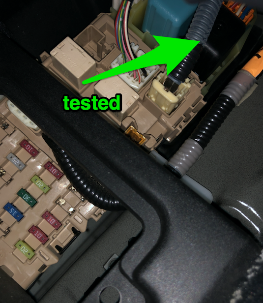

I've been going through the existing threads on troubleshooting my blower not creating any air. Note: This happened at the same time that my a/c compressor died - coincidence? probably not.
What's been done:
-Replaced the blower motor control module

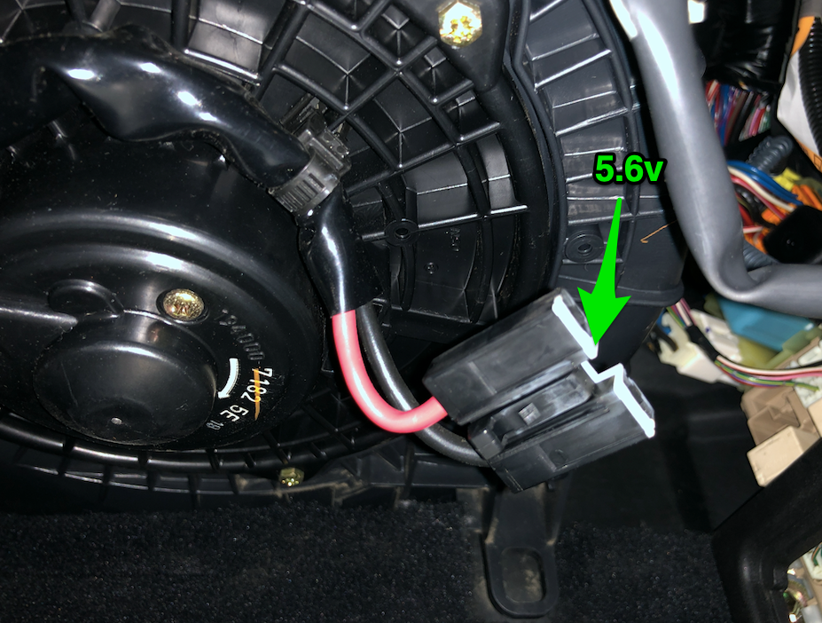

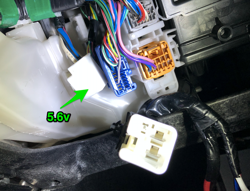

-Tested 5.6 volts all the way to the wires going into the blower
-Ran wires to the blower itself from a 20V battery and it spun freely
-Tested the blower relay in the passenger kick panel
-Pulled the 10A fuse for the heater on the drivers side
-The battery is low, but I've been trickle charging it for 3 days and is holding about 12.8V
-50Amp Heater fuse by battery tested
Kind of lost at this point, ideas?

Does the voltage at the blower ever change when changing speed from low to high? If not I think you got a bad resistor. What brand is it?
