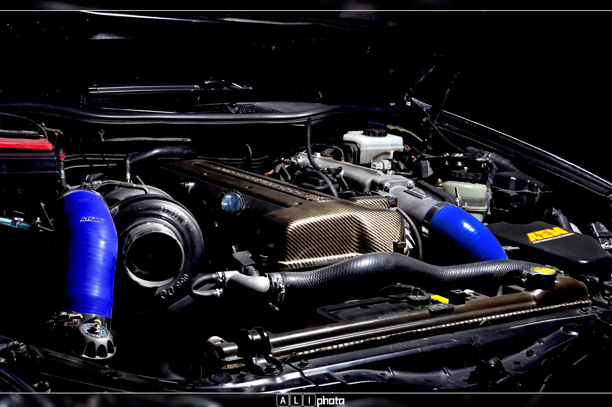

My problem is:
that the car runs rich only when i restart it while its still warm. If i let it to cool down for like 45 minutes before restarting it will run great.
if i start it while its cold i can drive, it runs perfect. AFR around 14.5-14.9 at idle and around 14,1-14.4 cruising. i drove it 60 miles few days ago without turning off the engine and it kept on running perfect. once i turn it off and back on again while its still warm, it started idleing 11.8-12.2 afr. and i won't drive it like that to be on the safe side.
Temporary solution:
i installed Greddy emanage ultimate and used the widband for autotune and let it make adjustments to the fuel map. and that solved the problem. so whenever i restart it again i turn on the autotune and the emanage will start adjusting the fule to get to the targeted AFR.
but now i wanna figure out what makes it run like that. i want the engine to run good without having to have the emanage on the car.
Another weird thing that it does after restart is that it would go lean when i start to accelerate and go back to normal when i start boosting or when the RPM is above 3k.
Any ideas what could be wrong before i start spending money on replacing parts to try and figure out the problem
parts i changed to try to solve the problem:
Temp sensor. ( also checked the wiring for voltage and continuity )
o2 sensor. ( also checked the wiring for voltage and continuity )
checked for vacuum leaks but nothing is leaking.
parts i'm going to replace to try to solve the problem and why i'm suspecting them:
1. MAF sensor ( i tried to let the emanage run the engine without the maf. it does start normal like if the MAF is there but the problem is still there)
2. MAP sensor ( from researching and reading about this engine, everyone say that the engine depends on MAP just for the boost cut. correct me if i'm wrong)
3. ECU ( why not)
4. fuel injectors ( i thought they might be getting stuck open. but again when the emenage start trimming the fuel map it fixes the problem so i don't think that this is the problem but who knows )
5. fuel pressure regulator
6. recirculate the pov ( i read that this might cause it to run rich but not on idle..)
infos about the car
1999 GS300
2jzgte vvti
stock JZS161 ecu
single turbo borgwarner 60mm
3" downpipe to dual 2.5" no cat with new o2 sensor ( replaced it 3 times. the one that came with the GTE, Denso, and bosch )
FMIC with the maf on the cold side of IC ( closer to the TB)
AEM AFR gauge
walbro 255
boost controller set to14 psi.
PCV deleted and the intake manifold port for it is closed
K&N 4" filter ( i just took it off to take the picture but i actually have it on all the time )
sorry for any grammar mistakes. English is a second language for me
