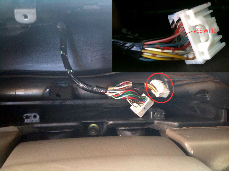

Speed pulse wire is on the harness on the cluster.

I got it from eBay like $50.... Search universal HUD there's literally 3 wires to connect + - and speed. I have no schematic though ( I need one if someone has) which wire is it in on the cluster? I intend to install blue LEDs in the cluster anyway.

VSS
https://www.clublexus.com/gallery/da...edownload.jpeg

Thanks a bunch man. I will give it a shot.
