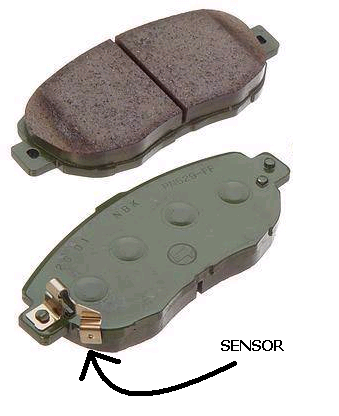

you probably hit the break sensor.
get new pads and resurfaced. 3mm is not a whole lot.
Brake sensor? And I know 3mm is not a lot. I was planning on replacing my pads and rotors this Summer, I just thought I had a bit more time to do it. My service manual says 1mm is the minimum thickness, so I was going to run my pads down to the bottom.

Sensor on the pad that tells you its too low.
$70 bucks, uh-uh dont think so. What did you ask them? More than likely $70 bucks is to do all 4. If you remove them and take them in ANYwhere, the most you're gonna pay is $15-$20 bucks. Midas charges $10 bucks each. Americas Discount tires charges about the same or $15 bucks. $70 has to be for all 4
