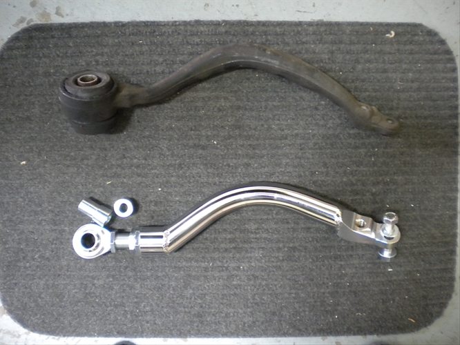

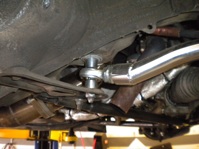

Also take a look at my old control arms!

Yeah that "control arm no. 2" is common, most people don't catch them when diagnosing front end suspension problems even when there is a lot of info on this board about them.
I had Daizen caster arm bushings for a little while but it turned out that I was sent the 98-00 instead of the 01-05 that I needed. So I ditched those and went for the Nagisa ones. Never looked back since and I love them!

I've never noticed any noises from these. Even if they did, I'll gladly take a little bit of noise over the steering wheel vibrations I had before I got these. I also have Daizen steering rack bushings and Daizen control arm bushings and I don't get any squeaks or funny noises.
I had the Daizens for a little while but they didn't fit like they were suppose to, obviously. So I gave them to my buddy to and he installed them on his 98-00 GS and they fit like a glove.
And yea, my car isn't the quitest car around But when I'm just cruising its actually pretty quiet so if they did make noise I'm sure I'd hear it.
Ya the newer (with the flat area before the bushing) LCA #2s have a larger diameter bushing than the early models.
Old Jul 17, 2011 | 12:04 AM
mex lex's Avatar
mex lex
Joined: Dec 2006
Posts: 3,214
From: Kyoei USA
Yup. I was aware of that when I ordered but I was either sent the 98-00 on accident or I accidently ordered the 98-00 without realizing it.
