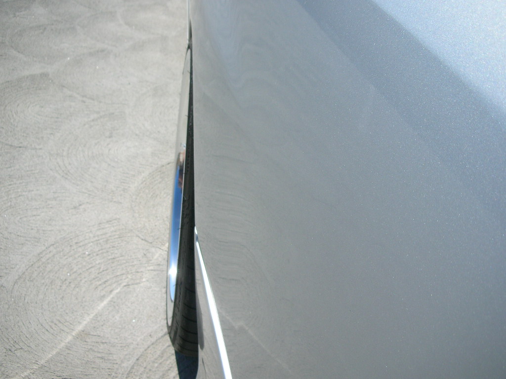

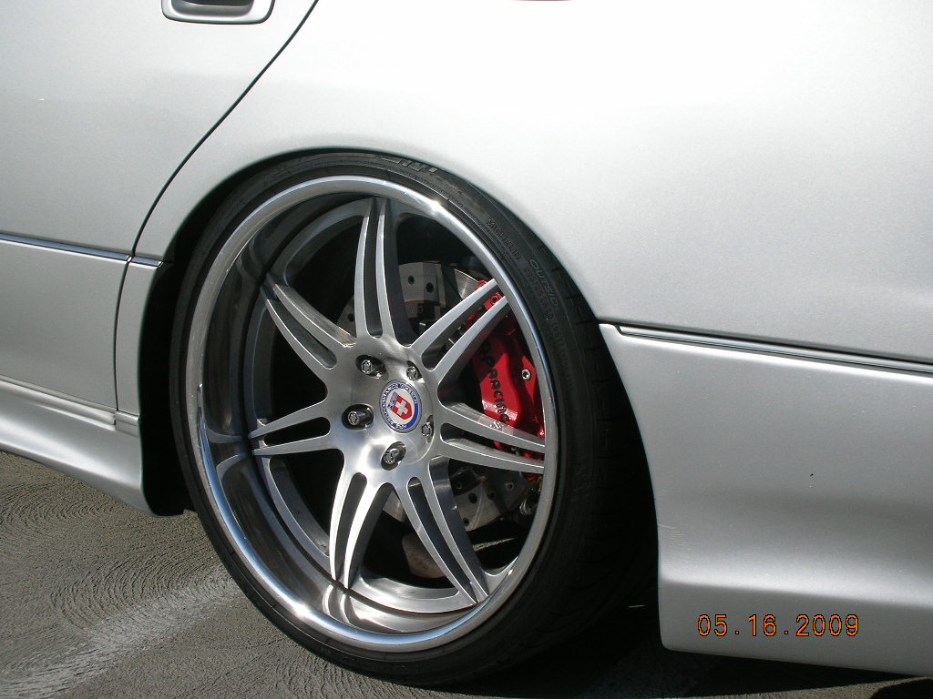

That is ENTIRELY incorrect. Maybe on a Honda/Acura with thin sheetmetal that's true, but not the GS. There are many members on this forum for that have been running full shaved with no issues for 5 + years. Just between me and one other local member, we have over 100k miles driven.
So get a belt sander and shave it all off ! !
Here’s the inner lip areas after everything was shaved smooth and then primered. This was followed by silver and then all but the last ½ inch by the lip was sprayed with rubberized undercoating.
Here’s what my set up looks like with about 1 to 2mm of clearance between the fender and tire, but I have Zero rub at any drop. If you roll the lip you WILL NOT get as much clearance as this set up since the thickness of the metal gives less clearance than shaving it off. I'm running 295 tires on 20x 11 rims, so this is pretty close to the limit without pulling or cambering. Since this discussion is ONLY about shaving options I won't go into those other options.
