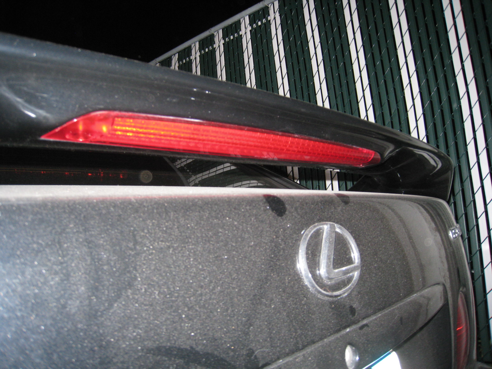

For me at first i tried to be slick and do it w/out removing the spoiler and that took almost like 1hr. got frustrated since i didnt have a hex screw (forgot size) to remove the spoiler so iwent out bought the right tool and removed it. after that all it took was 10-15 min to re-route the new wiring and hide everything nicely back inside the trunk. i choose not to splice the wire because it was old and i live in NY so its exposed to rain/snow and whatever comes out the sky. check the pics, i just snapped some real quick with a p&s since its dark.
perfect fit around the whole trim sorry was lazy to resize the pics.
