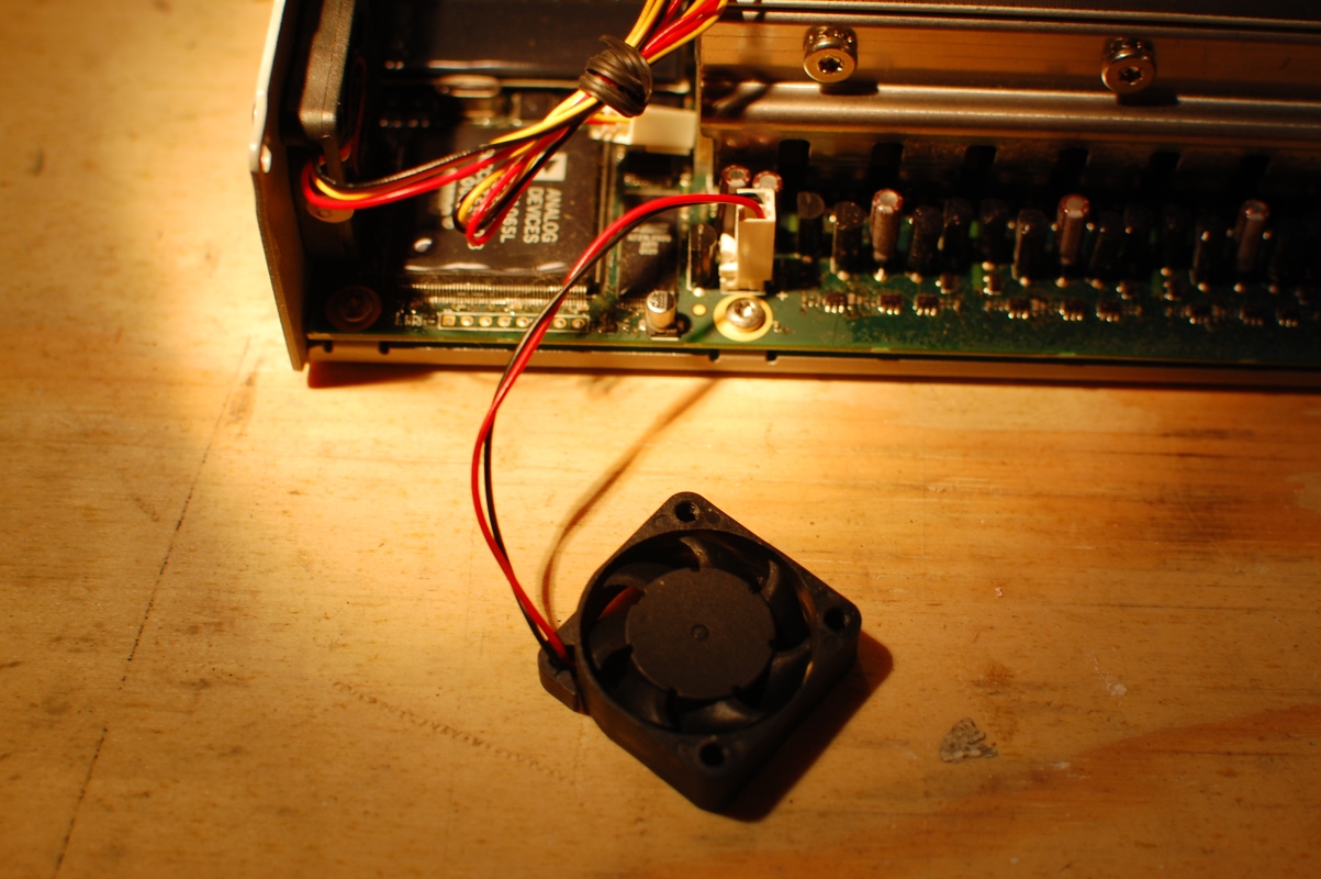

Here is the old fan removed but still plugged in. The fan operates as an intake fan.

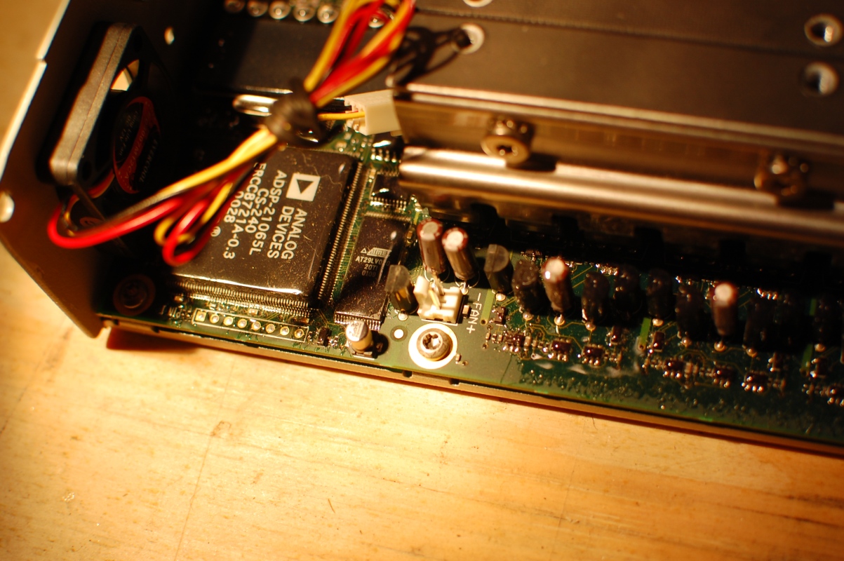

There are three screws that hold the fan to the chassis from the outside. New fan is installed on the left.
Here is the new fan installed but not yet plugged in. The leads came wrapped just so, the perfect length.
The replacement fan is a three wire fan (yellow allows rpm detection), but the red and black are together in the correct order and fit right on. Yellow remains unconnected.
This was such an easy replacement.
I ran the amp until it warmed, and the fan came on as expected -- silent.
