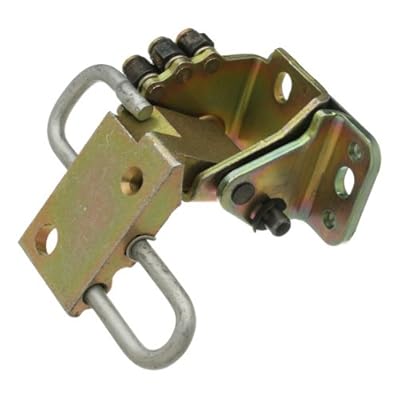

Has anyone replaced this themselves?
Mine is dragging on the door and the service dept said that I need to replace that part.

Not the hinge, the "door check"
its an actually part
thought the door check was the hinge? (I looked up door check and got this)

Found this write up its for an RX, but has the same door check part number. Looks pretty easy:
http://www.lexustsb.com/getattachmen...A3LnBkZg%3D%3D

Thanks for that! So the door panel does have to come off... okay.

If its just a noise problem, you can use some wd40 on the arm and work it in. Use very little and work it in good.

yeah I greased it for now and it sorta fixed it but I just have a feeling the noise will come back. Eventually that thing will need replacing.
