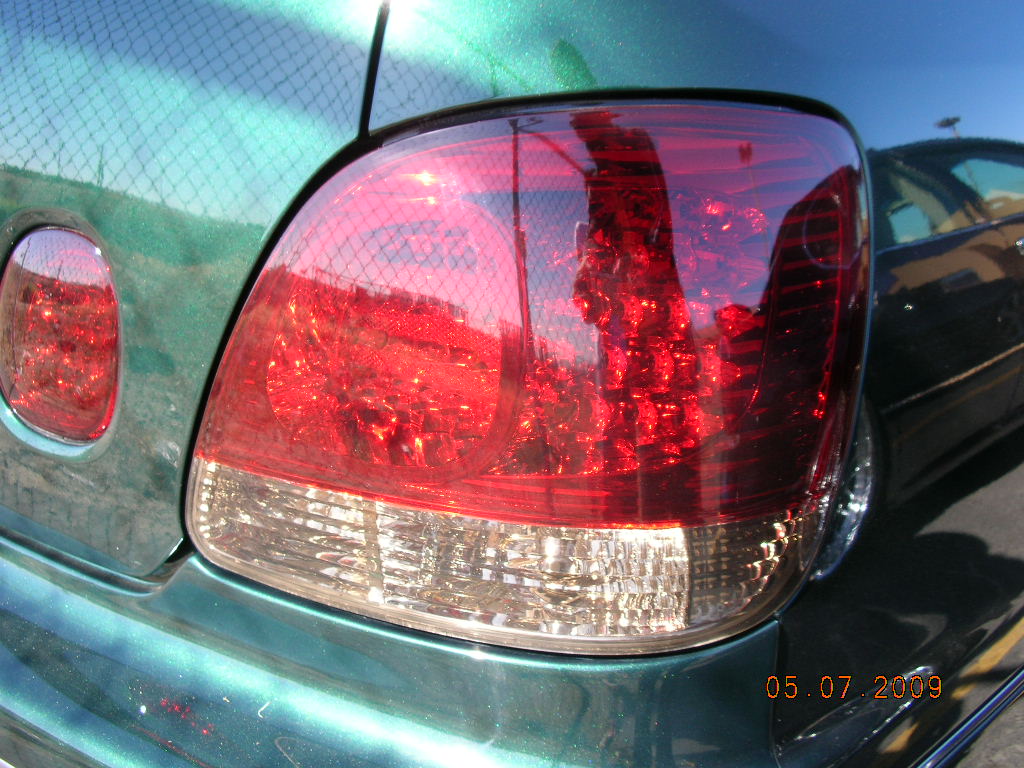

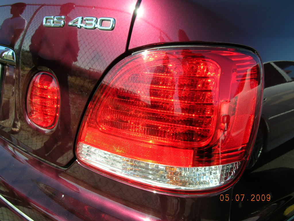

I was going to post earlier in the thread, but the discussion became a bit misleading, so at this point I'm not going to go back and answer each post but just comment what I gathered from various replies.
- The 01 up lens can be removed, but it's not easy. The two methods I am aware of to do it without cracking, is to cut it out with a dremel on the black plastic section in order to leave the lens undamaged and then it can be trimmed clean. The other is to bake it, but I have RARELY seen it done "cleanly". Photos DO lie sometimes.
- I can see how someone who wanted LEDs with a 01 up lens could do this, but the way I understood the OP, is that they wanted the JP cleared tails, so using the stock 01 up lens WILL NOT accomplish that.
- On the 98 - 2000 tails many people have cleared it out by removing the lens and taking out the amber piece. In the 2001 up OEM tails the amber WILL NOT come out just by removing the lense.
- On some of the posts I read, it appears there might be some misunderstanding on what people thought someone did or didn't do or perhaps what they were looking at was not what they thought.
So to clarify:
A. If you want the "dead on" JP style cleared 2001 up tails, but with LEDs then I only see one "practical" option.
1.You would need to buy the JP tails, remove the lens and install it on the aftermarket LED set of your choice.
B. If you just want a LED tail with cleared out amber that matches the OEM 2001-up thickness then you have at least a couple of options.
1.The clear sections on the Insurance tails and all other aftermarket tails do not match the clear sections on the JP which are completely clear; you can see the bulb and reflector very clearly on the JP turn signal section. If this small difference does not bother you then you can have the JP "LOOK" by just buying the Insurance tails. They have a red color border around the clear, which matches the OEM "Look" the closest.
2.The ones posted by McDj18 have a thin clear, but do not have the red color border like the OEM 01-up tails.
3. If you are OK with the "snowflake" LED tails, or like the tails in #2, then you can paint the red trim around the lower section of the clear, using candy apple red model paint. If you do this the thickness of the clear will be exactly the same thickness as the OEM 01-up tails.
4. The Sonar/Wise/Carson tails have a clear section that is a lot thicker. You could paint the lower section red, but it will not match the OEM thickness.
