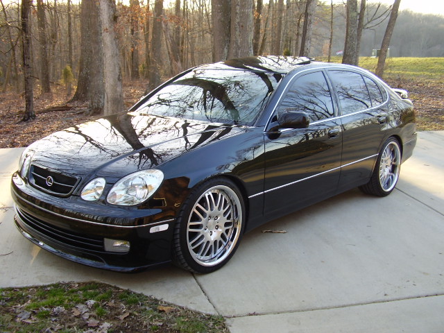

Chris, here's my set-up: 19x9 +19 wrapped in 225/40/19 and 19x10 +20 255/35/19 and doesn't look stretched at all and I'm lowered. So, I say 225/30 and 255/30 should somewhat look like my set-up. I know it's not 20's but the tire sizes gives you a good idea of how it looks. Hope this helps and here are some pics to help you out a bit more.
