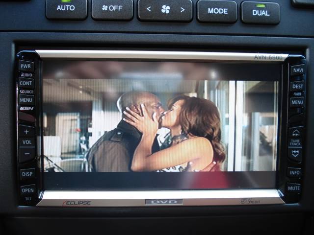

I'm sure this question has been asked several times already in the Audio section and you would probably get more feedback there! To give you my .02 I just added the Eclipse DVD/NAV unit(6600) with the Ipod interface and Sirius,but have yet to activate the Sirius radio! I love it!The factory amp you will probably have to bypass. With the Ipod interface all my cd's are on my Ipod so there was no need for me to upgrade to a disk changer! The oem disk changer would be no good to you with an aftermarket system, I don't think! Good luck and keep us posted!

^^That looks so sweet.....The unit, not the kissing scene

Based on your siggy it say's you have the 5435 unit?As far as getting the sub to work with the aftermarket unit, I doubt it!
Thank's!
