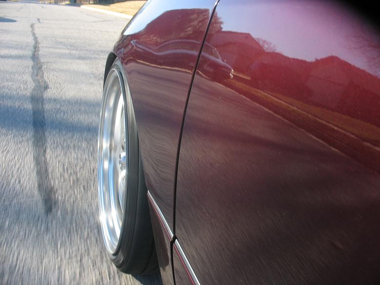

gato u gota send me close up of all ur wheels.. wow!
on a 20 inch wheel I'd probably go as slim as possible for the reasons you've mentioned. also what type of suspension do u have that will make a big difference in how ur car responds to road defects. if u can, I'd jack the stiffnss level up all the way on susp, if its adjustable.
I think we`ve all lost tires and messed up fenders its part of the game u gota experience it one time or another. I actually did this on my MR2 I had put some new pirelli Pzeros (not no nero either) 255 35 18 on my rears had to drive 2 hr to get back to school..and that was the worst feeling ever I rubbed the tire alll the way from cleveland back to columbus. The tire was tore up by the time I'd gotten to campus..I feel for you brother.. just put some 225s up front like gato said would be best choice.. ill look like u hid your tires too =) do some research on here everybody is great on this forum, ull find guys with ur size wheels find out what worked for them. I'm currently doing same thing, gato has been a great help with that.
