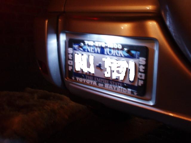

I tried the polarg m4's in the plate area, and they turn yellow brown after a while. Here is a pic of the 5LED in the plate area of my Rav4. Note* This is one 5 LED superwhite bulb in the plate area. This has the same look as the 3rd gen GS plate area. Imagine two of these bulbs in the GS plate area
Where did you get these? I tried LEDs from an ebay guy and they are wayy too blue. Needles to say I switched back.
