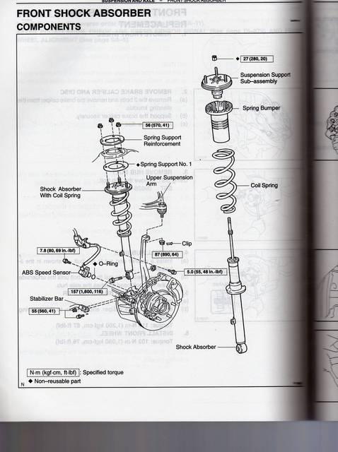

big pics

Nice. So what part is defined as a strut top?
Suspension support sub-assembly
spring bumper
spring bumper
The strut top is the suspension support sub-assembly. I requested a quote from Sewell Lexus today for the strut tops and the part in the quote is identified as the suspension support sub-assembly.
It looks like there are many schools of thought on replacing the strut tops. Some say always replace them when you replace the shocks. Others say there's no need to. And then some say that you only need to replace the front strut tops because the rear ones experience very little if any wear.
By the way, Chuck, thanks for taking the time to post pix of the service manual. That's really helpful.
Isn't this a solid piece of metal and no moving parts. I haven't taken one of these apart and can't imagine they could be worn. Now the spring bumper looks to be made of plasic/rubber so I can understand that being replaced.
Experts please pipe up and tell me I am wrong.
Well, if you look at the diagram for the front struts, it shows a spring support (that is part of the overall support subassembly) that is not reusable. Maybe that's why you can't reuse them.

the cushions and spring bumpers are rubber. that is what can wear. I wonder if you can get just those parts instead of the whole top assembly?
e-I also happen to have my stock shock assemblies out in my garage if you want actual pics let me know.
btw-I believe the non reusable part is just the top nut e.
Hmm, not that I'm trying to complicate things here, but that's a really good question. Are there part numbers for the cushions, supports and bumpers? I'm guessing not, and you have to buy the whole subassembly, but maybe. I don't mind spending $64 for each front subassembly, but the rears are $100 a piece, and for something that's not supposed to wear that much, that seems pretty excessive, don't you think?
I would think the tech can tell when he takes apart the old shocks, if the rubber parts are worn or not. maybe you should buy them and only use them if the old ones are bad.
