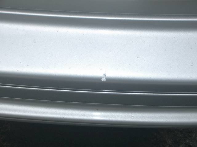

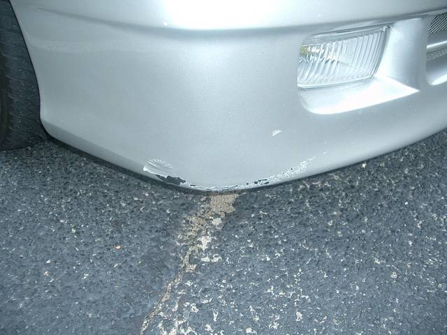

well, i guess its bound to happen since my car is my daily driver, but i already scuffed up my new paint job REALLY bad in 2 spots (1 front and 1 back) both happened on seperate occasions, and its just sucks since i have to get them redone i guess you can say it was my fault, so im gonna have to deal with it anyway, since i know everyone here loves pics, here ya go
FRONT BUMPER:
REAR BUMPER:
i guess it could have been worse. but it sucks i still have to get BOTH bumpers reapinted

Sympathies. The back's not so bad, can probably be masked with touchup paint. The front, though: ouch.

Whoever sprayed that front bumper didn't do the best of prep work. Looks like the paint just fell off. Some adhesion promoter would have prevented that. Well...the scratches would still be there... Anyway...I sympathize with you....scratched my front bumper on a concrete thing in a parking lot the other day.

I agree. Paint scuffing is one thing but it should not come off in a sheet like that.

yeah that's what i noticed as well. it's like those paint just completely peel off. unless your paint hasn't even fully dried up yet, that's sub par prep work. just imagine if you get rock chips or so, you will see the paint peeling as well!

That is exactly what I thought when I looked at it. Since you are going to be repainting anyway you should see if the paint scrapes off like that anywhere else. It looks like you can just peel it away. That is not a good job and they should redo this at no cost to you. What else did they paint for you? I would be worried that this can happen to anything else that was repainted

hmmm... im in no way, shape or form familiar with body work, so im not tooo sure what everyone means by it not being a great prep job. can someone elaborate for me so i can figure out what i need to do. i was not too happy of how the paint peeled like that, but i thought that since it was an aftermarket bumper and not factory, thats how the paint was any help is appreciated.

On any flexible body panel (plastic, urethane, fiberglass) an adhesion promoter should be used. This will help the paint "stick" to the surface. Otherwise, when ever the panel is bent, hit, moved, the paint will have a tendancy to just peel off...as in your case. There is also a chance that the paint was not applied correctly. Had it been, if you just hit something, you would have had scratches...not paint falling off and bubbling. I would go back to the body shop and see if they'll work with you to repaint the pieces.

Now that I look at the pics again, it also looks like they did not use any sort of primer...I assume the kit came black since you can see black where the paint fell off. This looks like very substandard paint work.
