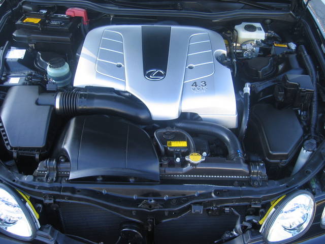

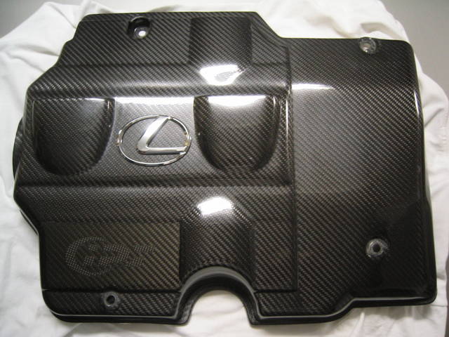

Here is a pic of my engine and another one below. See the different covers which I am referring to: (in short do 99+ GS 300's have this cover in the 2nd picture?)
My 98 GS.

I don't recognize which engine that carbon fiber cover goes to, but it is not stock. The silvery cover is from a GS430 and only came on cars made after 2001+ . The cover from the 300 is different than the one on the 400 as well. Installing the torque converter will be more difficult than doing shocks/springs; you'll need a hoist as you will have to drop the tranny out. Precision Industries makes two different TC for the GS; one for the V8 and a different one for the I6. The one for the 300 (I6) is actually a little more expensive as I recall, maybe $50-$100 more but should still have the same effect on straight line acceleration. Sway bars should be easier than shocks/springs to install. If you use the Daizens , remember to take off the rear end links and reverse them 180 degrees.
