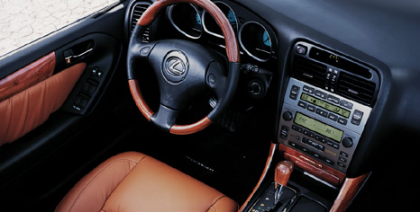

Originally posted by 2KGS400
If that's the case how come the 01-04 steering wheels are safe? If a strong epoxy was used to mount the emblem wouldn't it just stay in place when the airbag deployed?
I'm reposting the pic from the first page. Notice how the chrome L is in an internal circle that is separate from the airbag? The L does not move while the airbag deploys around it.
In this retrofit case that you are talking about, the L will probably stay in place on the airbag but the whole airbag comes at you with the L still on it.
I hope you understand my explanation.

I saw an 02 Q45 with an plastic infiniti emblem at a junk yard. The airbag cover split in such a way that the emblem was entirely on lower half.
yup, design were taking into consideration to make sure it doesn't fly up

That's a very nice looking (98-00 GS) steering wheel.
The chrome emblem (added to a 98-00 GS) does not seem to be a problem in an accident, at least to me. Here's why. The chrome emblem is attached to the air-bag cover, not the air-bag itself. The air-bag cover will either fold up or down out of the way so the air-bag can deploy from underneath it. I've had an air-bag deploy on one of my other cars (non-Lexus) and there was no way the air-bag cover would hit the driver's face. If so, it would cause a lot of damage to the driver even without the chrome L on it because of the velocity. Thankfully the hard air-bag cover does fold out of the way and the air-bag is what hits the face. In my accident, I never even hit the airbag because my seat was so far back and the seat-belt automatically cinched up tight in the impact.

what if the cover is designed to split in half?

wow that thing is beautiful, I wish I can afford it.

is that cupholder a stick-on piece? looks pretty sharp in that pic

the airbag cover will flip upward, unveiling the airbag ! yes, the add-on dash kit is an add-on real wood trim with a 100 % color match !
