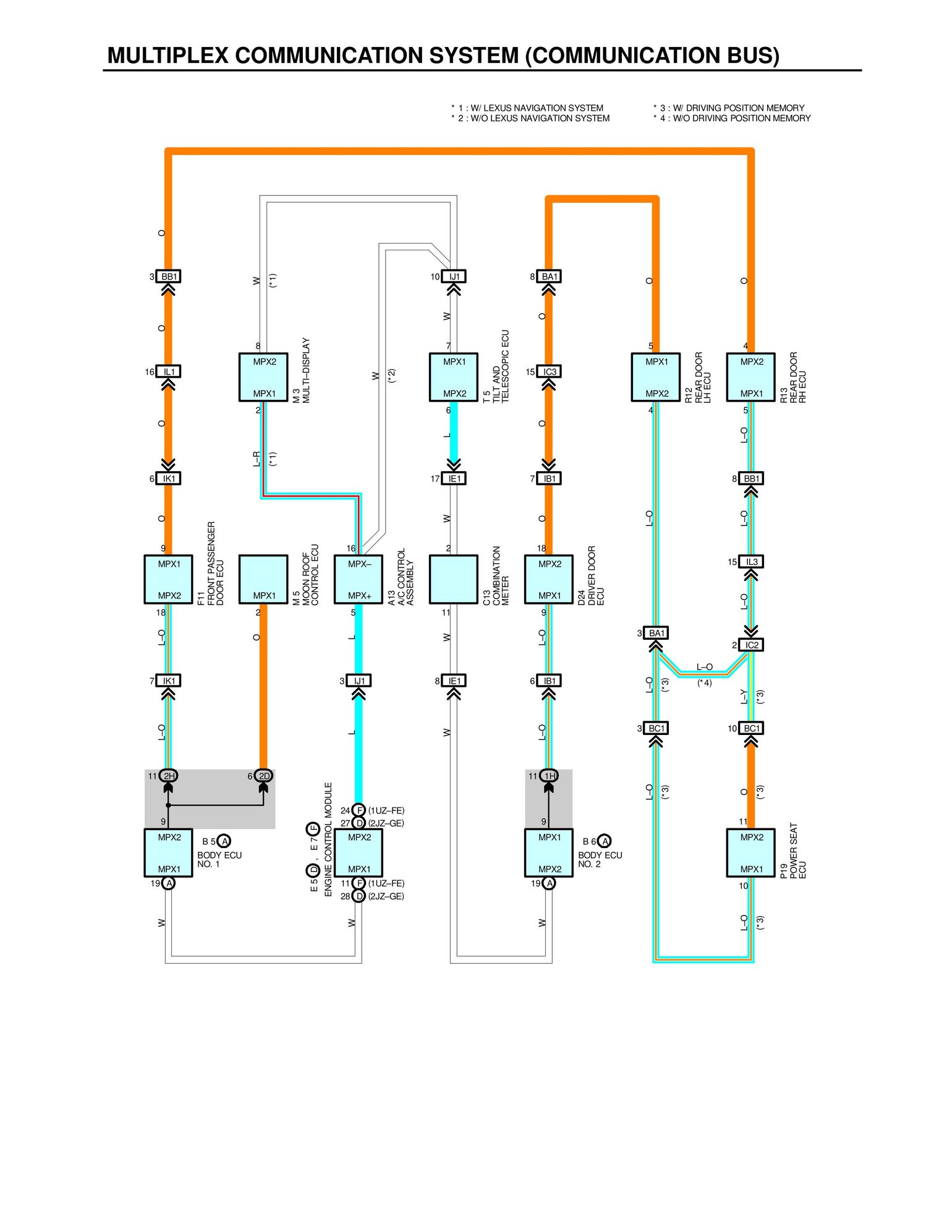

Hello,
It appears that you are reaping the consequences of a rather strange decision made by Toyota back in the day - All the Body ECUs in that car are connected in Series with each other, meaning that disconnecting one ECU in the line disables all the other ones. Below is a Diagram for the Communication Bus on those cars, it appears that you will have to go over all the ECUs listed there to check for Internal Damage, or the Faulty Connection, as far as I am aware, there is no better way to do so, even if you have Techstream for help.
Hope this helps and best of luck!
