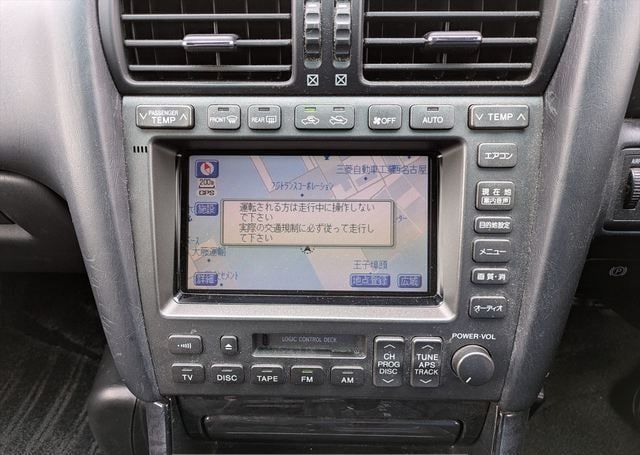

i got a 1999 Toyota aristo with touch screen nav and found the Grom vline android. i was wondering if anyone else had added this to there Aristo. I'm totally down to order it just want to make sure it works with the Japanese version of the nav system.

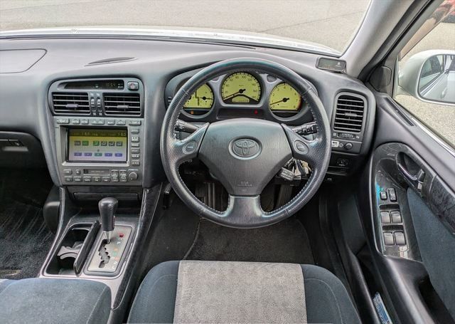

Wondering same thing. I don’t wanna hijack the thread, but will explain a lil of my situation.
Just picked up a 2003 aristo v300 vertex edition. A/C is integrated into the head unit.
what makes this even more difficult is I currently live in Japan and it is tough trying to translate what I am saying. Also popular shops like autobacs/yellow-hat will absolutely not modify the car any bit, especially something like this.
to add, I did email Grom, specifically toward the same system you inquired about:
Send us a few pictures of the headunit screen when in AM/FM and Nav mode.
If VLine is compatible, I suggest keeping the headunit as replacing it may cause more issues down the road.

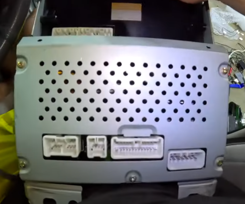

I think you will run into a problem as the pre 2000 Aristo (Maybe 1997-1998?, not sure if 1999 is included) has an old style navigation with completely different plugs. The 1999 or 2000-2005 Aristo has identical plugs and harness to the 2003-2005 GS300, GS400, GS430 where they split the navi unit from the stereo head unit. See pics below.
1997-1999ish navi and stereo integrated as one
2000+ Aristo separate NAV and Stereo harness, identical to 2003-2005 USDM GS
fingers crossed i will tear into the dash once i get the Vlite.
with my frame number mine was likely built either end of 2000 to jan feb 2001. hopefully that makes a difference.

no good. Older nav.
