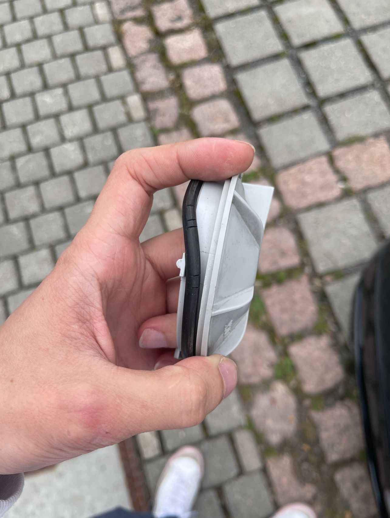

All done with new lenses
The hardest part was the outer rubber seal. Original one is a bit fancy shape-wise, and of course is not available separately.
Entirely new headlamps is the only option, if there is literally anything is wrong with yours, are you kidding, toyota...?
Bought 10x10 seal intended for house windows, made out of EPDM rubber, which should last forever
Made it into a loop via superglue, connection feels very strong, and looks ok-ish, if looking not too close
Excuse the quality
Excuse the quality
Also made holes with hot screwdriver for condensation to exit
Glue on the rubber strip feels fine, but could be stronger. Hope a pressure wash will not rip them off
