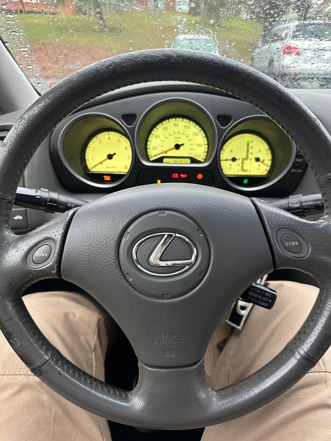

I recently purchased a 2004 GS 300 and I found out about e-shift and thought it was cool until I tried to use it. My e-shift won’t change my gears, and when I’m in M mode it is the same as if I’m driving regularly. I also noticed that my steering wheel has the up/down buttons but my speedometer doesn’t have the cut out for the gear selection like I’ve noticed others having. Lexus website says my car does have e-shift. I’m either just stupid or it’s broken, but I do need some help.

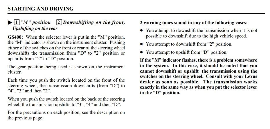

As far as I remember, the odometer display shows the M-mode and the current gear number.

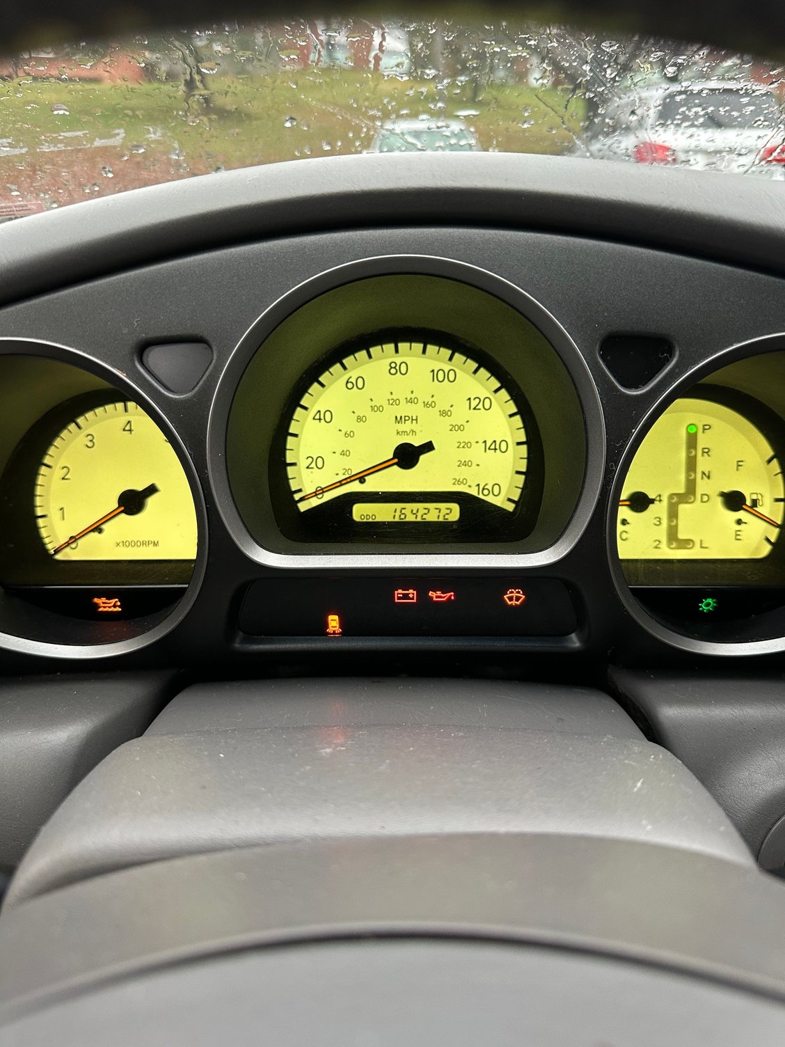

Thats what I thought but I found an image of what the cluster should look like I believe (sorry for the quality).
it shows the gear and m mode in that little section above the odometer. It’s just weird my car has an eshift steering wheel but not the odometer. I even used my vin on the Lexus website and it said it should have eshift. Maybe the old owner did something funky idk.

Is your Check Engine light on?
I'm beginning to suspect that the previous owner "fixed" all the problems by removing (or covering with black tape) the Check Engine, VSC, ABS lights from the dash.
This way, you won't see any indication of the actual problems, but the car won't go into manual mode for the automatic transmission. You also won't see any action from the VSC control button.
Remove the instrument cluster and check that all the indicator lights are in place and in good condition.
Another way is to connect an OBD-2 scanner to the diagnostic port and read all the stored errors from the ECU.

This is a photo of the instrument cluster of the GS300 / GS400 1998-2000.
I'll check it in a few hours on my car (GS300), on the way home. Will update later.
I know that on mine this mode works properly, and I saw the gear number indication.

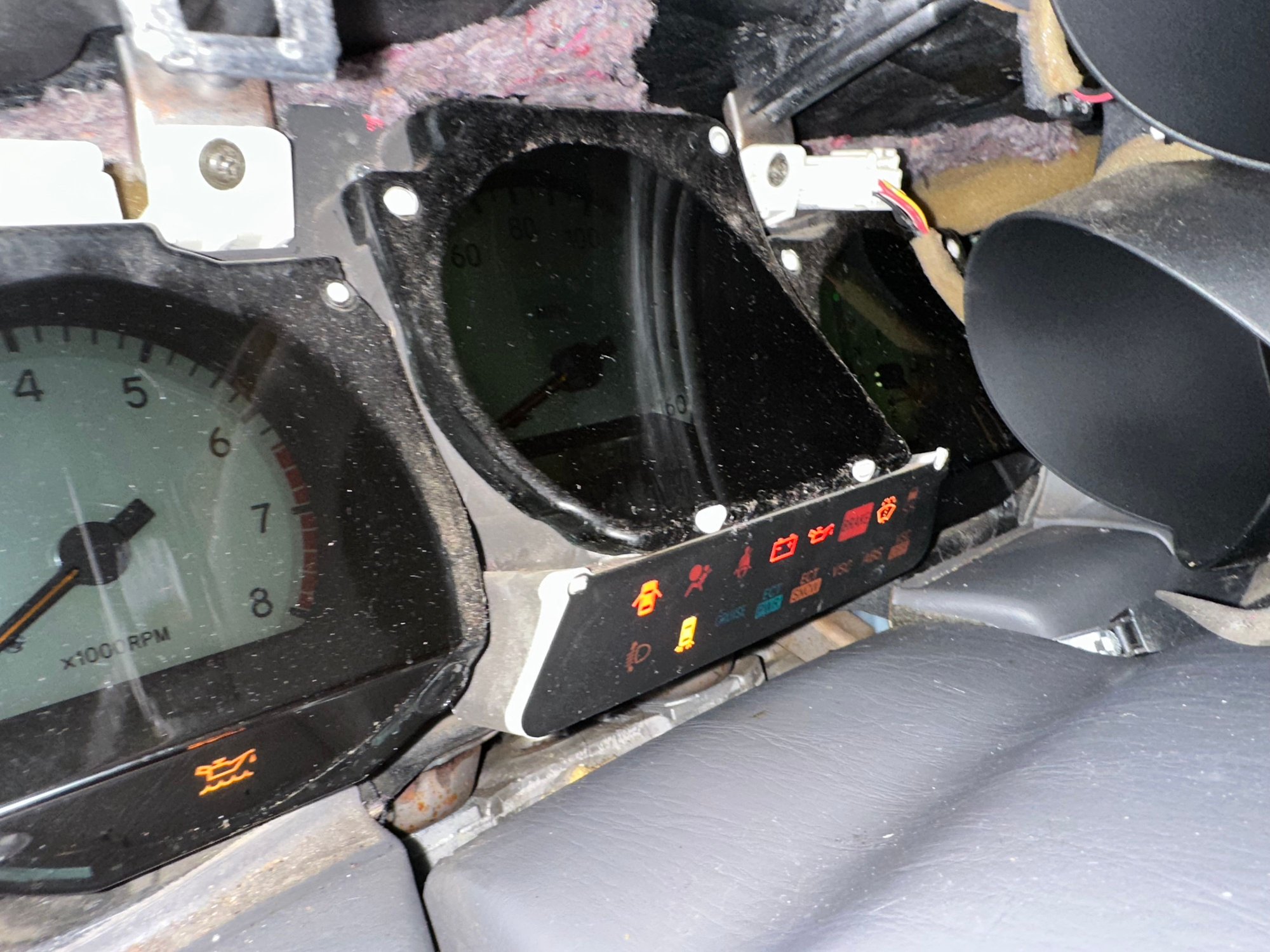

I think I see what's going on with your car.
The previous owner swapped the instrument cluster with the one from the previous generation (1998-2000) of the GS.
Take a look on the differences:
That's why you don't have an E-shift display and the Power Mode / VSC indicators don't respond.
Sorry man, that's typical seller's scam. The junkyard dash probably had a quarter of the car's actual mileage or so.
The 1998-2000 GS300 models did not have the E-shift transmission.
