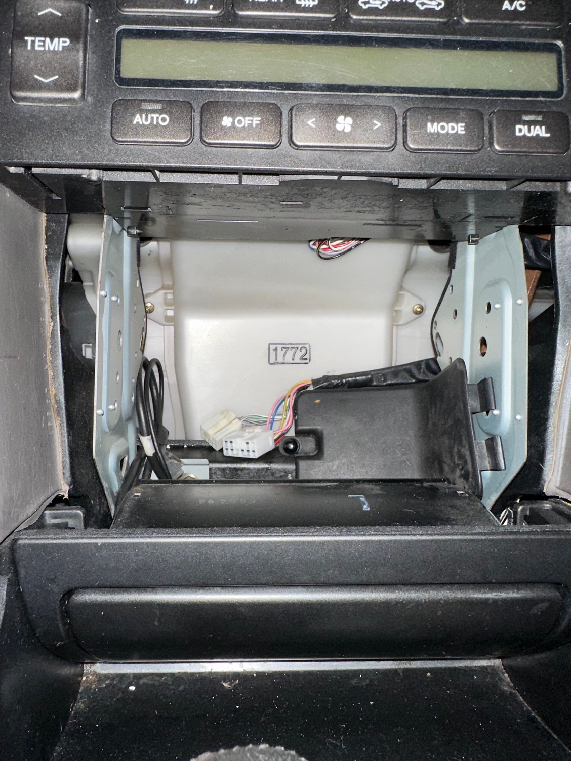

Previous owner took the head unit out cause apparently it wasn’t working well but he never got around to replacing it. Can anyone shed some light on what kind of head unit I can hook up here? Or how to tell myself what sort of adapter and unit I’ll need. Right now all I know is it’s a double DIN sized space haha

You will need one of these adapters to install any aftermarket double DIN stereo system.

I am about to do this for my newly acquired gs300. I believe these OEM parts should allow you to fit a double DIN stereo. I don't like the metra kit, because it looks like it's not color matched to the HVAC controls
86211-30241
86212-30221
55412-30480
Old Aug 4, 2024 | 07:49 AM

I guess my main concern is how to adapt the stock harness into an aftermarket set up. I can splice wires but I’d always rather buy a premade adapter if the price isn’t outrageous.

You will have to bypass the factory amp for the sub. I will get a cheap 50w amp with a lpf so I can keep the factory sub. Don't feel like spending the extra cash to upgrade it yet.
The factory amp is useless to you. You can drive the factory speakers from the head unit. Metra makes a harness for this.
Idc why people wring their hands over cutting the factory harness though. These are not collector cars, and the factory stereos are ****. I'd rather just focus on making clean splices, maybe even labeling them.

Not to hijack this thread, but mine is in the trunk, so I don't need to bypass right?

If it looks like this and you are trying to install an aftermarket, yes.
