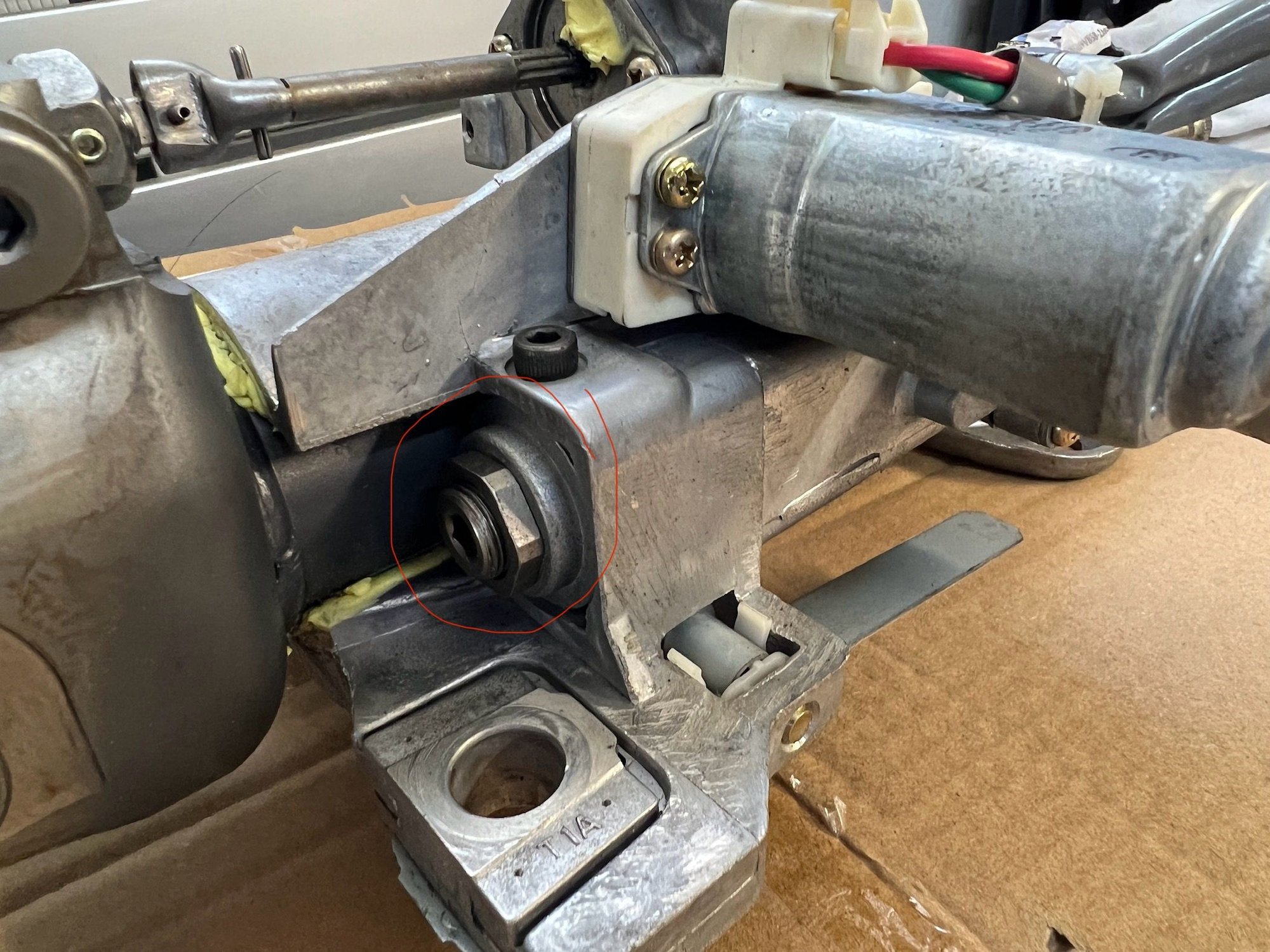

Hello, I have a 98 GS400. i’m planning on cleaning the tilt wheel motor thing bc it’s going super slow and getting stuck. i’ve read a lot of posts and stuff on how to do it but i was wondering if anyone could show or explain exactly where to re grease on it?

I’m working on a thread to grease the telescoping wheel. If the tilt is the problem you can follow the posted thread. The telescope is more difficult as you can’t access the lead screw.
You can spray some in around the cover for the tele lead screw.
