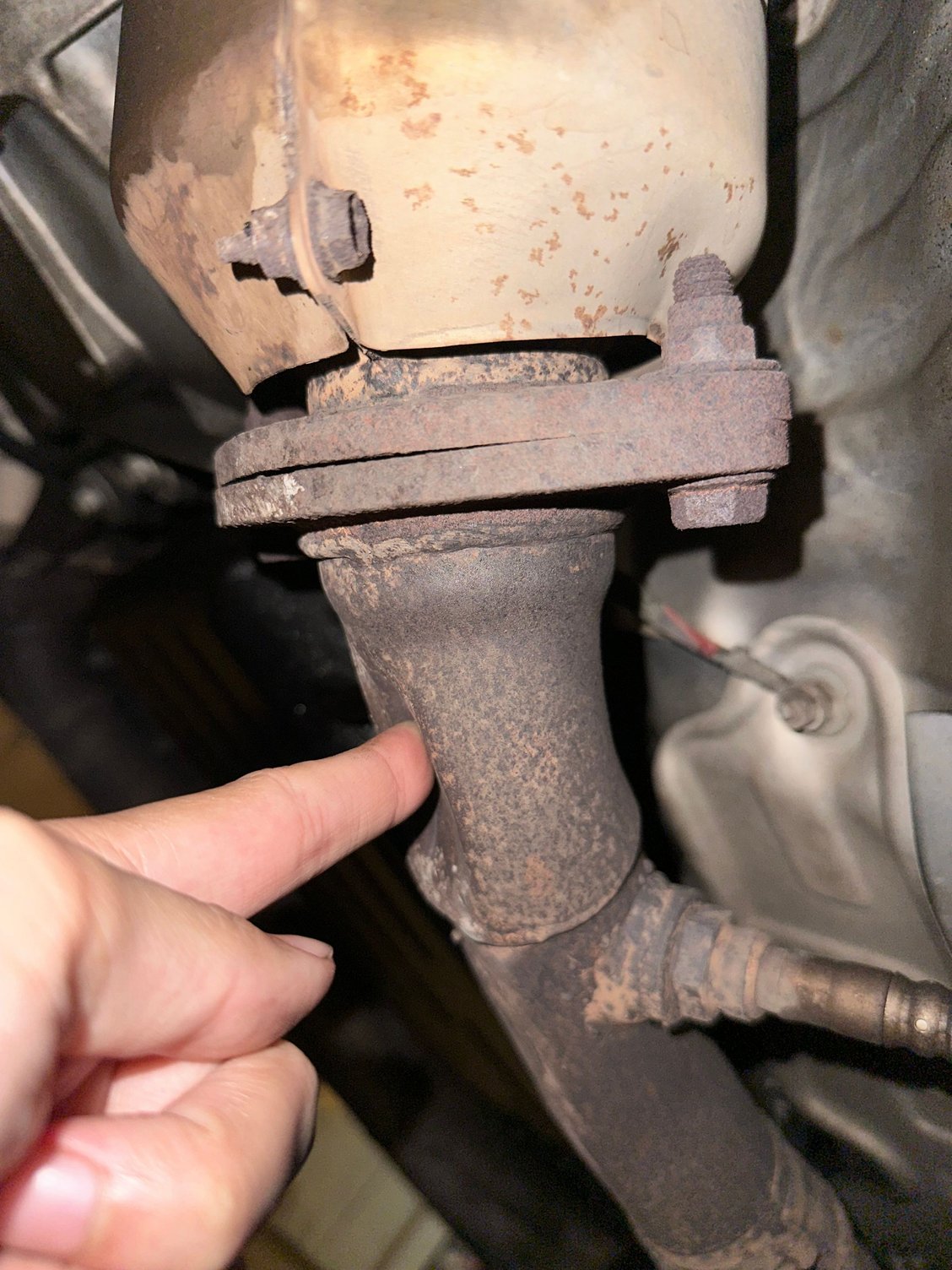

Hi just wanted to update. I know it’s been a while but I took a better look under the car while I was changing my wheels, and what do you know, the exhaust got dented by the hit! Here’s a picture! Lmao.
Driver side:
Passenger side:
Another angle of the driver side dent:
Soooo I’m thinking the flow restriction is causing to O2 sensor to pick up more of… whatever it picks up, hah. To circumvent this I will be installing a spacer and possibly replacing the piping at some point.

If the impact split a weld seam, and caused an exhaust leak, that will throw off the O2 sensor readings. I see a big gap in the exhaust flange in the bottom photo, at the bottom of the cat. Looks like left side. Check if bank 1 is on the left. You may want to have an exhaust shop straighten out your pipes and the flange.
