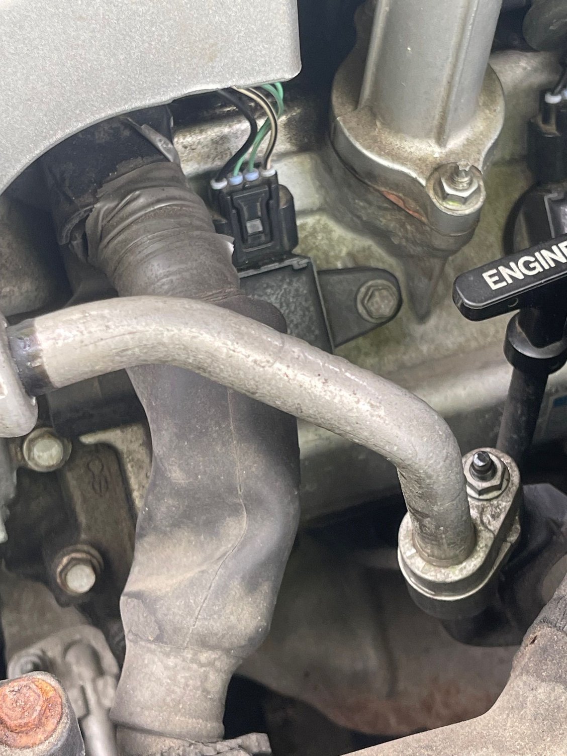

Hey guys,
I got a slow refrigerant leak, and at this point I suspect it could be a bad compressor speed sensor o-ring.
Excuse the crappy pic, my car is a little low, so I was struggling with pointing the phone right
I gonna refill the system with a UV dye next week to see for sure.
O-Ring is only available in a complete set, from US. Shipping will be long and little pricy.
I think I can source one locally, but I need to know the size.
I could take mine out, but if it's damaged heavily- it can fall apart and compressor will be left sucking the road dust.
To sum all up- if you have a bad or spare GS430 compressor laying around- I would highly appreciate you taking the o-ring out and measuring it for me
Thanks

I can clearly see the hose 887123F041 is leaking like craaazy, the oil is pouring down it.
Yet, it won't glow in UV. At all
I took a pic in day-light to show better, but night time does not make any difference.
Still I am not scammed, since I can clearly see UV agent residues glowing bright-green in filling port. Even in day-light.
Dys make me confuzion.

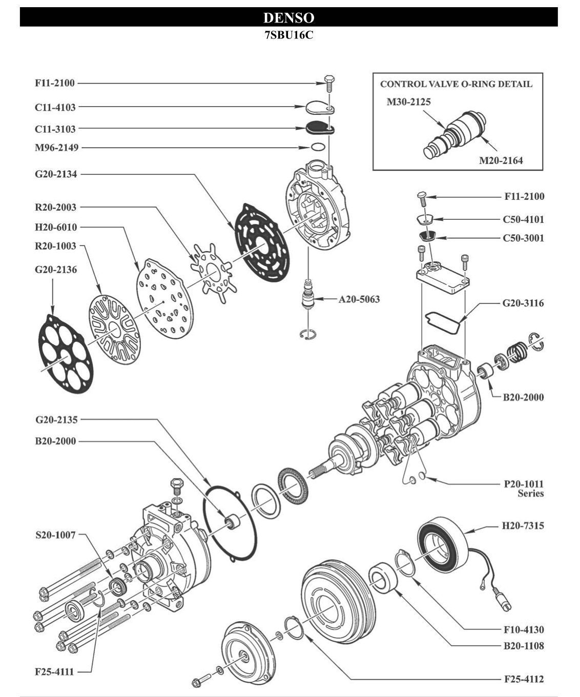

I am pretty sure that you have 7SBU16C, as that is what matches with the Part Number listed in the Parts Catalogue for your car, but let's just hope that you won't need to find out.
At least the issue got resolved ... maybe for now ... but anyway, thanks for getting back and confirming!

A little update on the matter
Oil on the sensor was coming from all the way above, from leaky heads (now fully serviced ), trough the wiring harness, ending up where I saw it
So speed sensor was never the case, and o-ring, as I suspected, was perfectly good. I might bring the old one back in later, since I trust it more, then an Amazon kit
And since I am not seeing any glow under the hood- evap core must it be, and an exciting adventure of blowing up my entire cabin is taking place next spring.
The veeery ugly smell inside, after car seated for a while, is even more confirming that..
