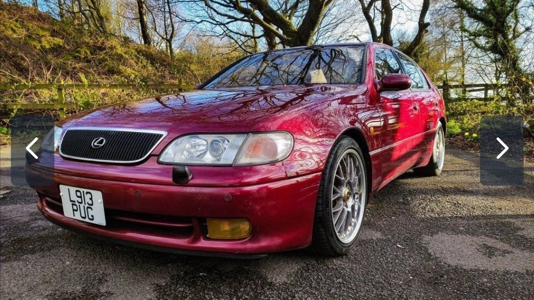

Anyways, a few days ago I saw this beatiful red 94 gs300 with 82797 miles on it and my first thought was to buy it and turbo it. What do you think? What should I look out for if I decide to do it? I couldn't find a modern guide. Pls help. Also I want to keep the car reliable as it will be my daily so between 300 to 400 bhp?
The Front
The Rear
The Rear 2: The Second Coming
The 2J

clean start. interesting to see parking sensors front and rear. must have been aftermarket. good luck with the build
