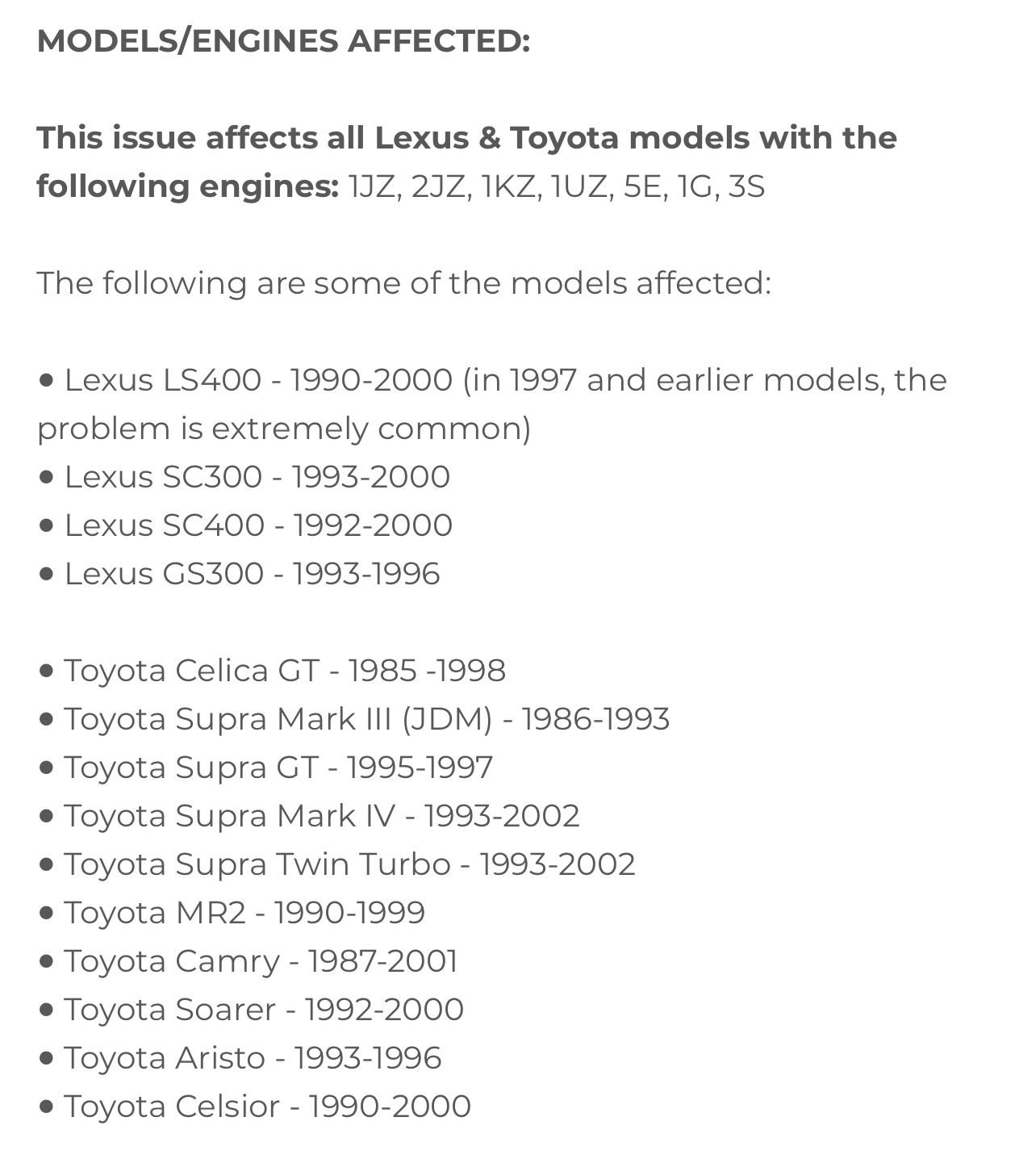

Well it turns out many Toyota/Lexus models are plagued with a failing capacitor in the ECU so the likelyhood of the dice coming up snake eyes twice in a row with these is apparently not uncommon.
Here's the list.
While it is true, I am still not convinced that two separate ECUs that came from totally different cars would have the same exact flaw, at least something must be different. If you look at the list of issues that could happen as a result of bad capacitors, it is pretty much endless, so the odds of you getting an ECU with the same injector failed twice in a row are vanishingly small. In any case, even if it is an ECU fault, it will never hurt to verify that everything else is working as intended before you will go risk your new unit, just for a peace of mind.
