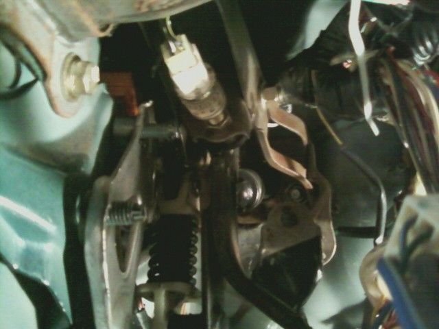

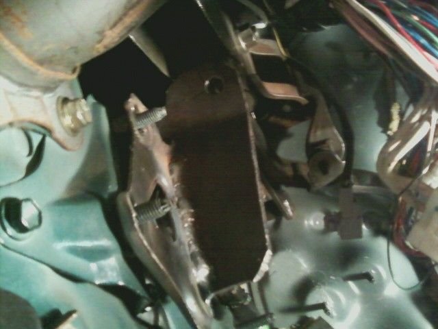

Those pictures are of the clutch pedal and the modified foot e-brake bracket. First photo shows the bracket cut down but still fitting on those two studs, and the second photo shows how i attached it to the foot e-brake (using that large sensor in the first video threaded through that hole)

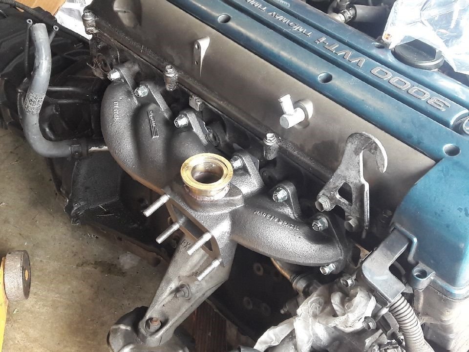

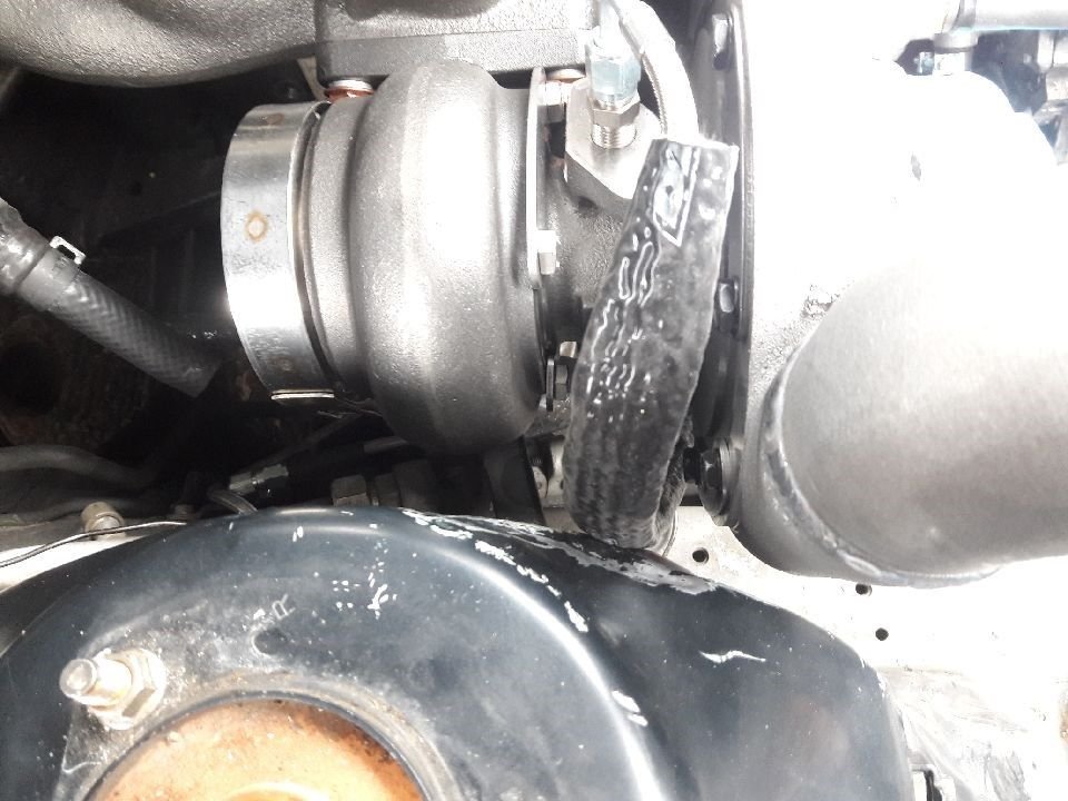

The ABS location on the jzs147 kind of sucks in comparison to other toyotas with the 2jz/1jz/7m. As you see here with my manifold, it puts the turbo right into the abs pump, and thats with the abs pump unbolted and lifted as far to the side as possible. Then there is brake lines sitting directly next to the turbo, which is asking for problems.. Pretty much if you single turbo swap this car don't use the manifold I used. Although the ABS location of the sc300/400 gives me no issues.

brazilian SPA with top mount waste gate. Quality manifold but just doesn't fit well with our setup. I can't even use a .88 exhaust housing because it sits too close, had to swap to a .68 a/r
