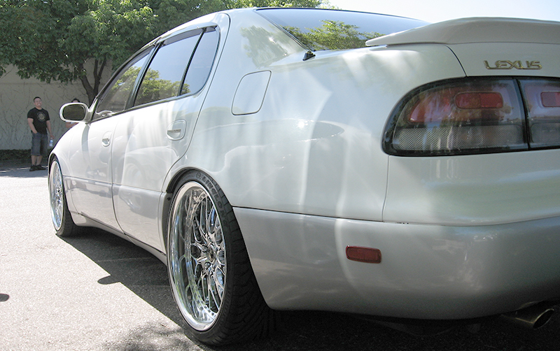

I have Tein's off of a JZS161 and I went pretty low; my question is, is there a camber adjusting kit for our cars? Reason is, my wheels butterfly some (I would say in front I am at -3) and I really would like my car low but my wheels straight and flush... kind o like this:
LOOK AT THE WHEEL FITMENT, NOT THE CAR ITSELF!!! My wheel sizes are 18x8.5 +29 F 18x9.5 +38 R

Yeah, if you want to go lower, put them up for sale and invest in a set of coilovers and a QUALITY alignment. You don't want to ruin your beautiful GS man!
