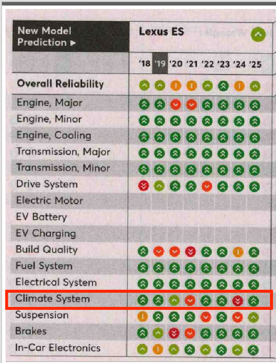

Consumer Reports identified model years 2021 and 2024 as problematic for the climate system.
I've never owned a car in 40 years that had the worst possible rating on any of those systems until the 7ES.
Odd - can't imagine anything was changed in just those two years.
Old Mar 13, 2026 | 07:31 AM
hotwings's Avatar
hotwings
Joined: Jan 2023
Posts: 727
Likes: 287
From: MA
I wondered the same thing.
There is usually a pattern but in this case reliability fell off a cliff in my model year for climate system.

The US Covid years were Jan 2020 to may 2023 maybe something to do with it with reduced work force and quality parts receiving issues? Lots of mix and match probably going on.
Also wonder what were the production dates of the cars that had the issues noted in the chart above?
Ex. For the 20 and 21 Engine Major when did production end for the 21 ES and what was different in the 2022 model with excellent Engine Major? Maybe early 22's had issues that were not in the CR rating?
Also what was different from 2019 with excellent Engine Major to 2020 and 2021 with such a dramatic increase in Engine Major problems?
Like having a scrambled egg go back in the original shell not very probable, will we ever know what Lexus did?
Maybe CR had some data problems in their chart development during the Covid era?
