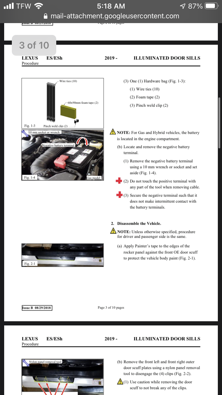

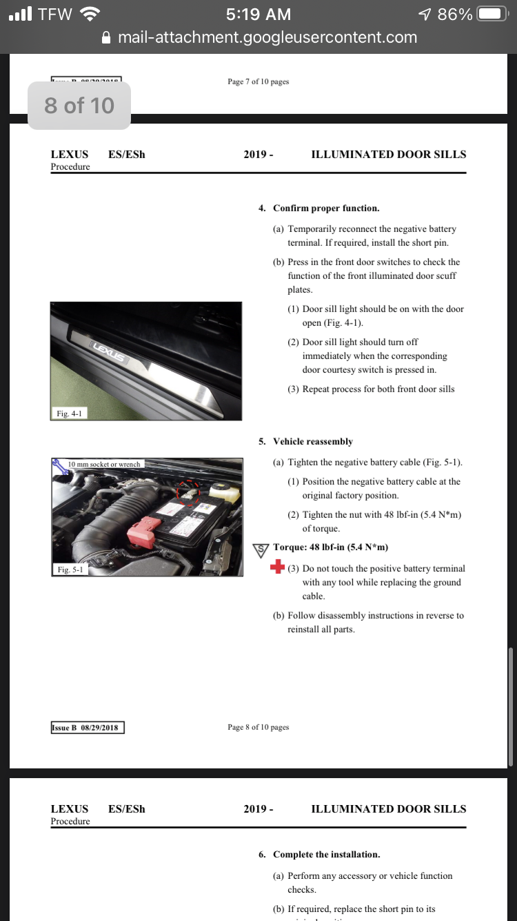

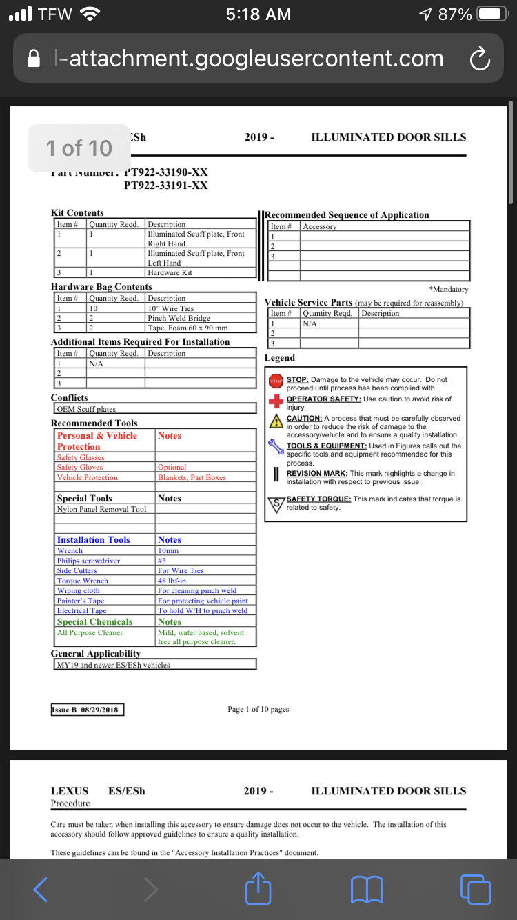

Default Led door sill instructions
Here is the DYI for the one door sills led

I put these in my 2019 UL. First side took about 45 minutes and the second, always easier, took about 30 minutes... Also inserted the logo LED's...

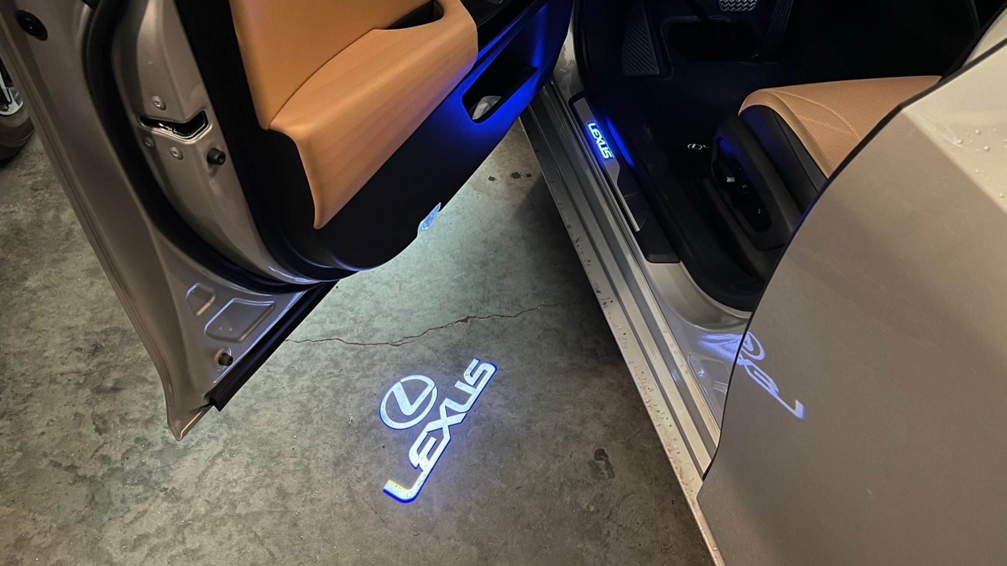

My car. Note there is a different part number for the white vs blue sills, order which one you prefer.

You do have to remove the covers to access the receptacle for the sill plug. Use a plastic pry tool for auto interiors from Ebay or Harbor Freight.
Your projector logo lights look better than mine. More defined. Where did you get yours?

Don't know how much a dealer would charge, but I think it would be a lot for an easy job. It's really just removing existing sills, tucking in the wiring, removing the kick panels on both sides, and connecting the plugs... Took me less than 1 1/2 hours to complete. I would rate it a 3/5 difficulty...I didn't do the trunk...
I got them from Aliexpress. I looked and the seller no longer sells them but they are available from other sellers. What I did when I was shopping was scroll down to the reviews area and look at actual posted photos of the product instead of the sellers photos. That way you can easily compare which ones are actually good and which ones aren't.
