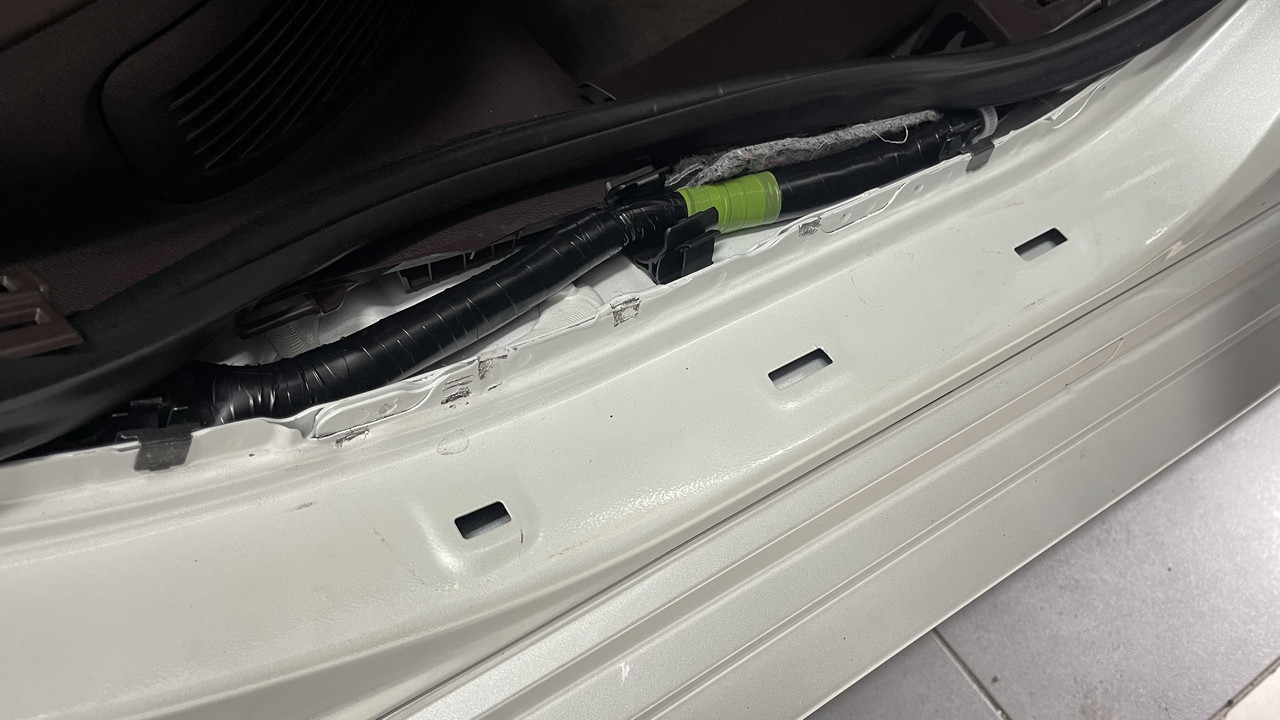

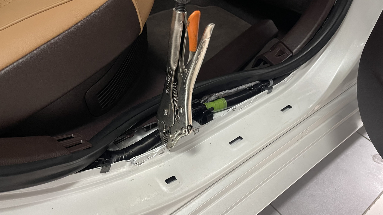

Now look at this:
I started to twist/press the sheet metal under the door, when I pressed with my fingers next to the first hole - KNOCK. The same stupid sound.
It seams like the sheet metal was not tight, I pressed it with these pliers, drove it and no noise. Nothing. Unbelieveable. This crap drove me nuts for more than a month.
Was that lip seam in the picture above that connects the rocker panel with the floor panel where you have the pliers separated and what was loose that was making the knocking sound? Were one of those panels that I'm describing hitting and touching the other panel while you were driving? Did you fix the knocking noise by squeezing the lips together with the pliers like you show in the picture above? I don't understand how the manufacturing plant didn't weld these 2 lips securely together to prevent the knocking noise. Aren't those two panels where they connect together that forms the lip supposed to be welded together securely at the factory? Or are they only supposed to be connected together without any welds in them? Which is it do you think?
Yes, the place where I put the pliers was loose, all the panels come to that place and they should be welded but in this case some of the welds are missing. I put the pliers and there was no sound, and then by squeezing the panels and pushing them
towards the seat the noise went away.
Like I said, there should be more welds and also glue between the panels. Also, on some spots there are 2 panel edges, on some spots even 4 panel edges.
